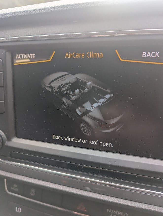

In short - the air conditioning/climate control doesn't appear to be working. I am 95% sure it was working before it went in for its first warranty repair, but i cant be 100%
When we click the setup button on the climate control system, and then enter the "AirCare Clima" menu, it states that a door/window/roof is open - when they are not. The doors are all shut (and when open the dash tells me they are open), and the car doesnt have a sunroof. The windows are also shut.

Thanks for the reply. Ive tried to attach a picture of exactly what I am seeing
I can also state without doubt that the little LED light under A/C does not come on when A/C is pressed.

Certainly looks like a preFL as that's an MIB1 screen
I wouldn't worry about the sunroof message, I suspect that's just a generic "car interior isn't a closed system" message

Its an MIB1, you can tell by the proximity sensor bar at the bottom of the screen, and the MIB2, which came with the facelift, looks totally different - MIB2 pic attached

Also, the picture on screen shows a left hand drive vehicle, this might suggest incorrect coding somewhere as the RHD/LHD coding settings change the pictures to reflect the car

You can without a doubt have the AC on and the windows open, I had a 2016 FR for 4 years. I think the fact that the AC won't enable the compressor is more where the issue is. All the AirCare system is an automatic closing of the recirculating vent for cabin air when it senses "pollutants" in the outside air. So it looks like there might be more than one issue.
Try manually closing the recirc vent and see if you can enable AC then, or even see if you can hear the recirc vent closing, it could be that is where the issue is.

Thanks again for this input. I've just had another go with the manual controls. If I press the recirculation button, I don't hear anything happening. However, when I turn the recirculation button off again, there is a single knocking noise coming from the glove box area. This knock also happens if recirculation is on and I turn the fan off.
Is that single knock normal?
In any case. Not matter what I do, the A/C will not engage (The little light onto he A/C button will not come on)
