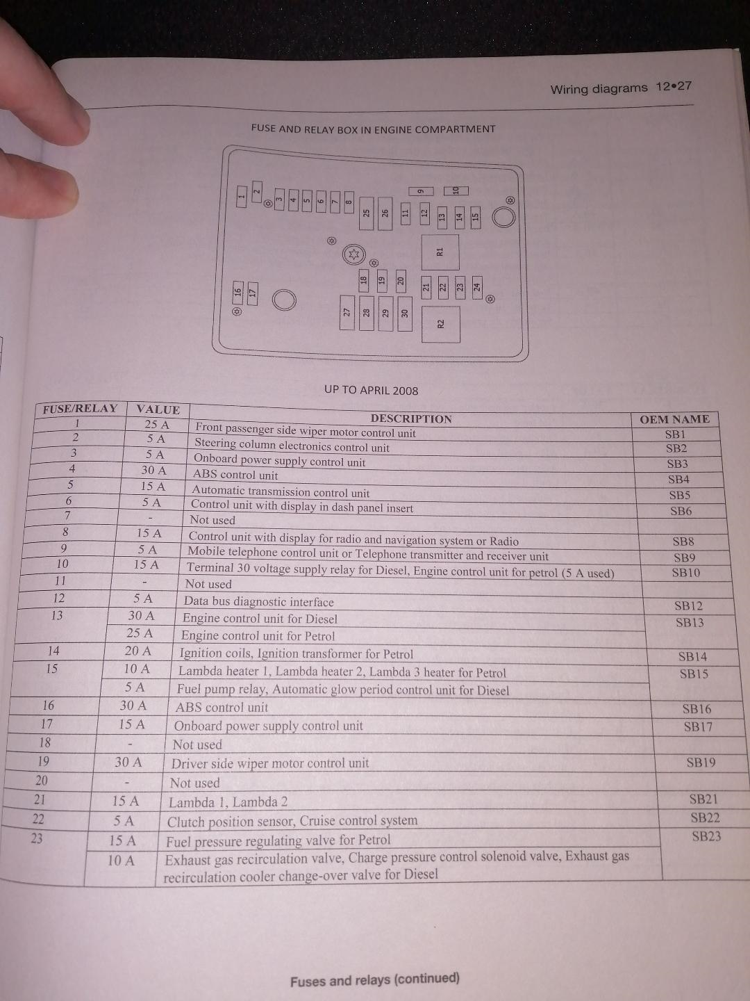

Hmm, maybe start here and see if you can get the front wipers sorted first? This is in the engine compartment... Fuse 1 - Passenger wiper motor, Fuse 19 Driver side wiper motor.

Hi Thanks for reply. I have already checked the fuses and they are also ok it has to be a relay or something else as the wipers were fine until the lights stopped working, I need to check the fault codes really looking for some obd that will do this.
