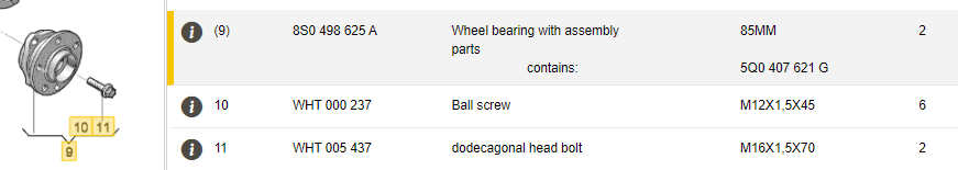

Hi all, I've just been looking at front wheel bearings on the Autodoc website and the front bearings seem to come in two sizes differing only by something tiny like 0.6 mm or so. Anybody bought these and do you know if the sizes are related to a year or a trim level etc

Ring dealership and ask them for part no is my best advice. So many variations. Or check seat etka online for the part.
There are two different knuckles (50 and 55mm) so it maybe depends on that.

Thanks guys. Etka doesn't recognise my VIN but there's a Seat dealership 5 minutes from my work so I'll nip over at lunchtime.

Front wheel bearing assembly OE part number off my 2015MY 184 ST
8S0498625A
