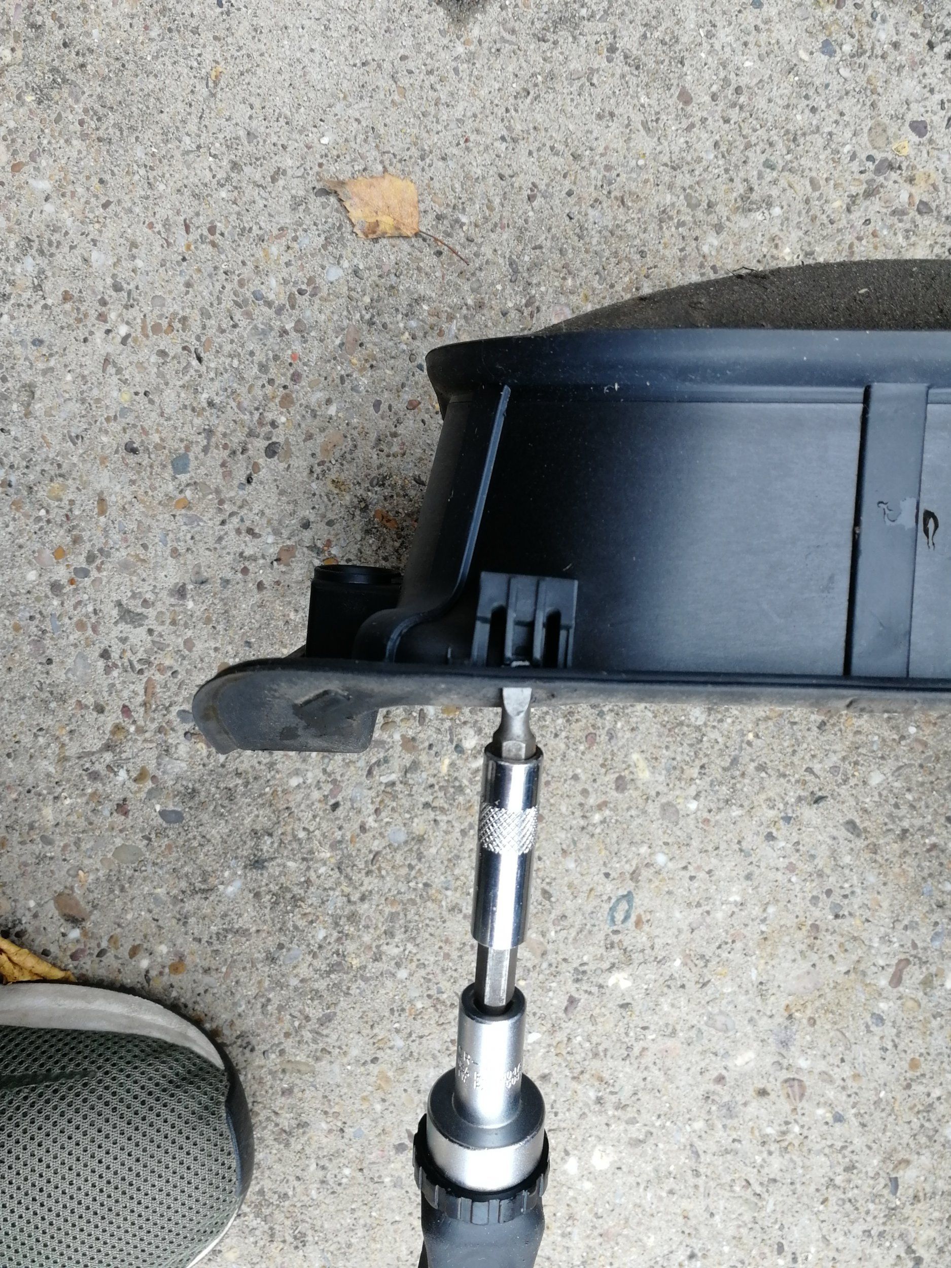

Just for information, to get the black surround out, it is far easier to use a flat head and pierce through the 4 clip points (pretty sure that's what they're designed for?). You get a flat head pierce it in, then lift the flathead up (so the flathead it going down within the clip), this easily unclips all 4 clips. Yes, you now have little holes, but I'd rather that than break clips or damage other parts. I think i will get a small amount of black sugru (just over the holes, not into the clips) and stick them shut again. This Job took me about 3 minutes.

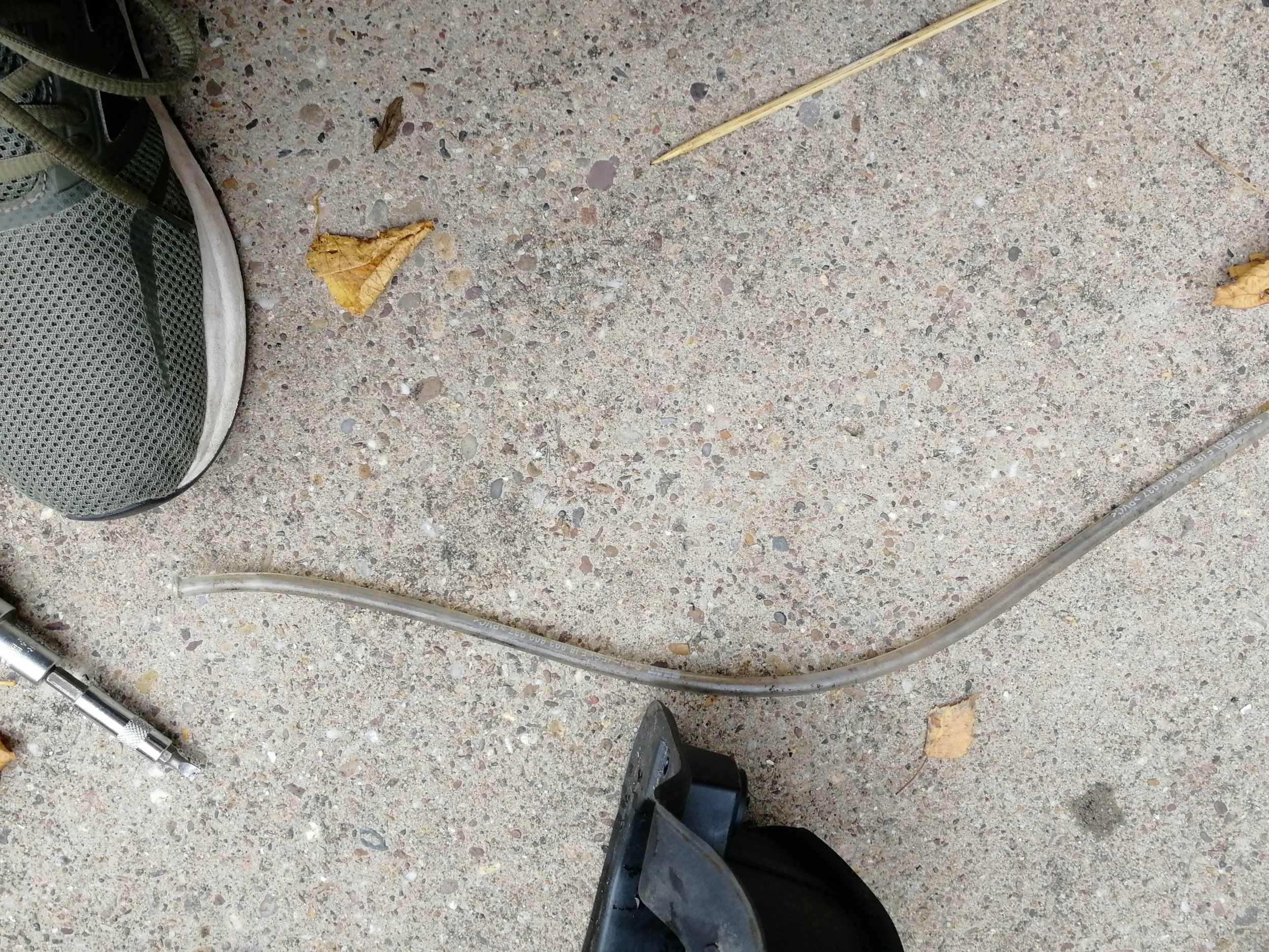

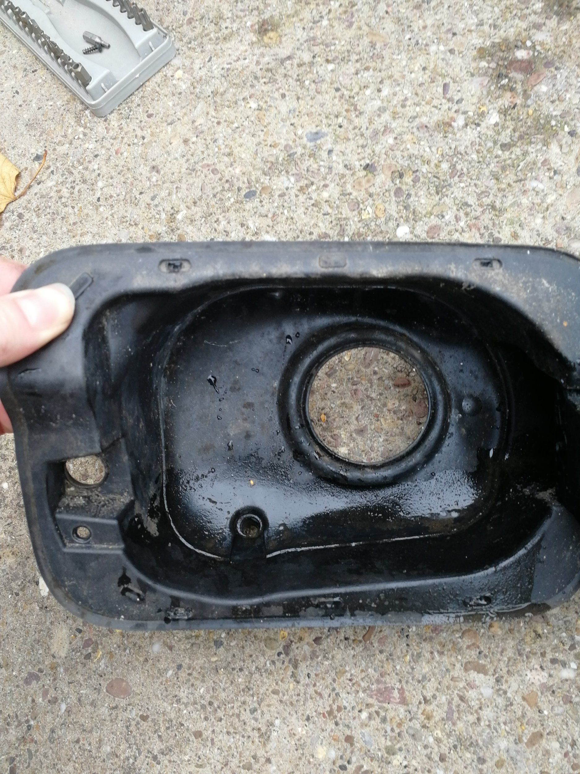

If you just take out the screw (allen key) near the actuator, and take off the fuel cap you can remove the whole fuel flap system (there is flexible plastic which holds it around the fuel cap, just work it lose). Its a great opportunity to clean through the waste water drain pipe too (which mine had blocked). See attached images.
I used this method and it worked fine.I bought a small tube of black silicone off Ebay and covered the indent holes with it with decent results.

They are at the corners basically.
It's pretty hard to get it off so I'd recommend a trim tool or something blunt so you don't do any damage.
Trim tool did the job thanks, the hole unit can come out if you remove the filler cap itself, then the entire assembly comes out easily. Fitted new actuator currently on part number 7P0810773F. Now fuel cap cover locking/unlocking as it should. If yours has locked up, persist with the unlock button, opened after about 3 attempts, whereas unlock/lock attempts didn't work for my 2013 MK3 Leon

Just did mine following your guide, was actually quite easy. Just a question though, Is the drain hole supposed to be connected to a tube of some sort? Couldn't see one.
There's a plastic tube which attaches to the black surround.Any fuel spill runs away through it.
