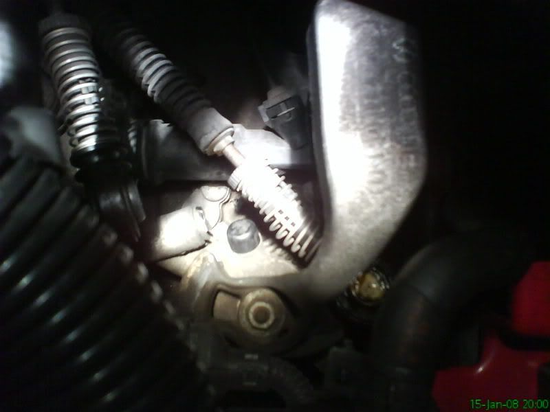

Guys just bought some Redline MT90 and ive found the drain plug but can anybody confirm this plastic bung is where you fill from?
Cheers fellers :)
no not there. there is another plug like the drain plug at the front of the gearbox like where the standard intercooler is. like on the front side. fill slowly till it starts to come out then put the plug bk in. just fill it slowly so it fills the diff and everything. its tight between the cooler and fill plug but its ok. even beta if u have diff cooler.
well elsawin advises 75w-90 oil for the gearbox and 2 litres of it for most if not all 02J gearboxes. I used castrol syntrax universal and so far ive noticed a lot smoother gear changes and less noise
