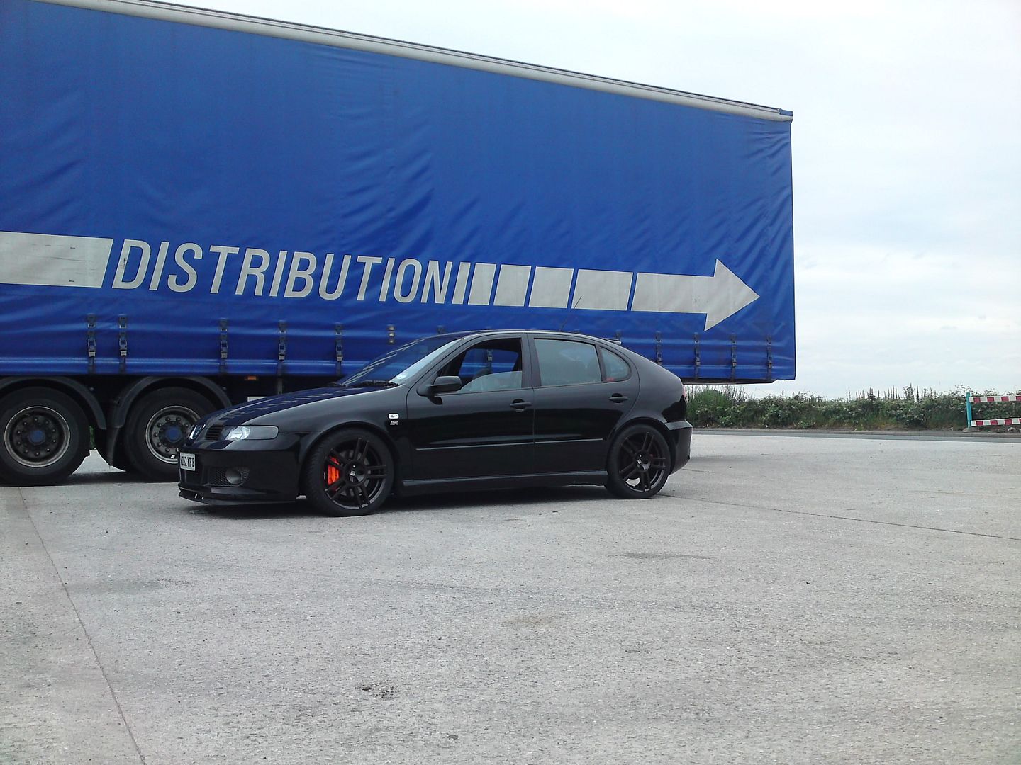

heres mine with 20mm drop. i still catch in car parks ect. also there are so many speed bumps where i live, going lower isnt possible for me so im happy how my car is :)
Ive only got this pic atm (not the best sorry)
