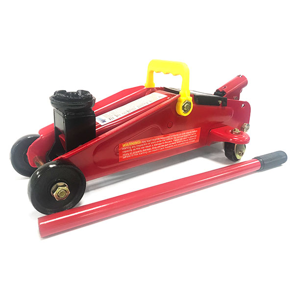

Hi guys this will be the jack ill be using and do not want it to slip off the jacking tower does the fact that the face on this jack is quite small make the chance of it slipping higher?

How likely a car is to fall off the jack, or any other support depends on a lot of things so there isn't a blanket answer. Use a three-ton trolley correctly and it'll be fine. Use a scissor jack on gravel and your car's probably going to end up on the ground.

Cheers for the help gonna need a jack with a bigger lifting plate tho as mine is quite small and dosent sit properly and when ever i start jacking it starts to slip
A lot of the smaller jacks have small heads on them. One thing I do is make wooden adapters for my jacks and axle stands so that they fit the sills tightly and won't scratch them. I'll take pictures and show you what I mean.
