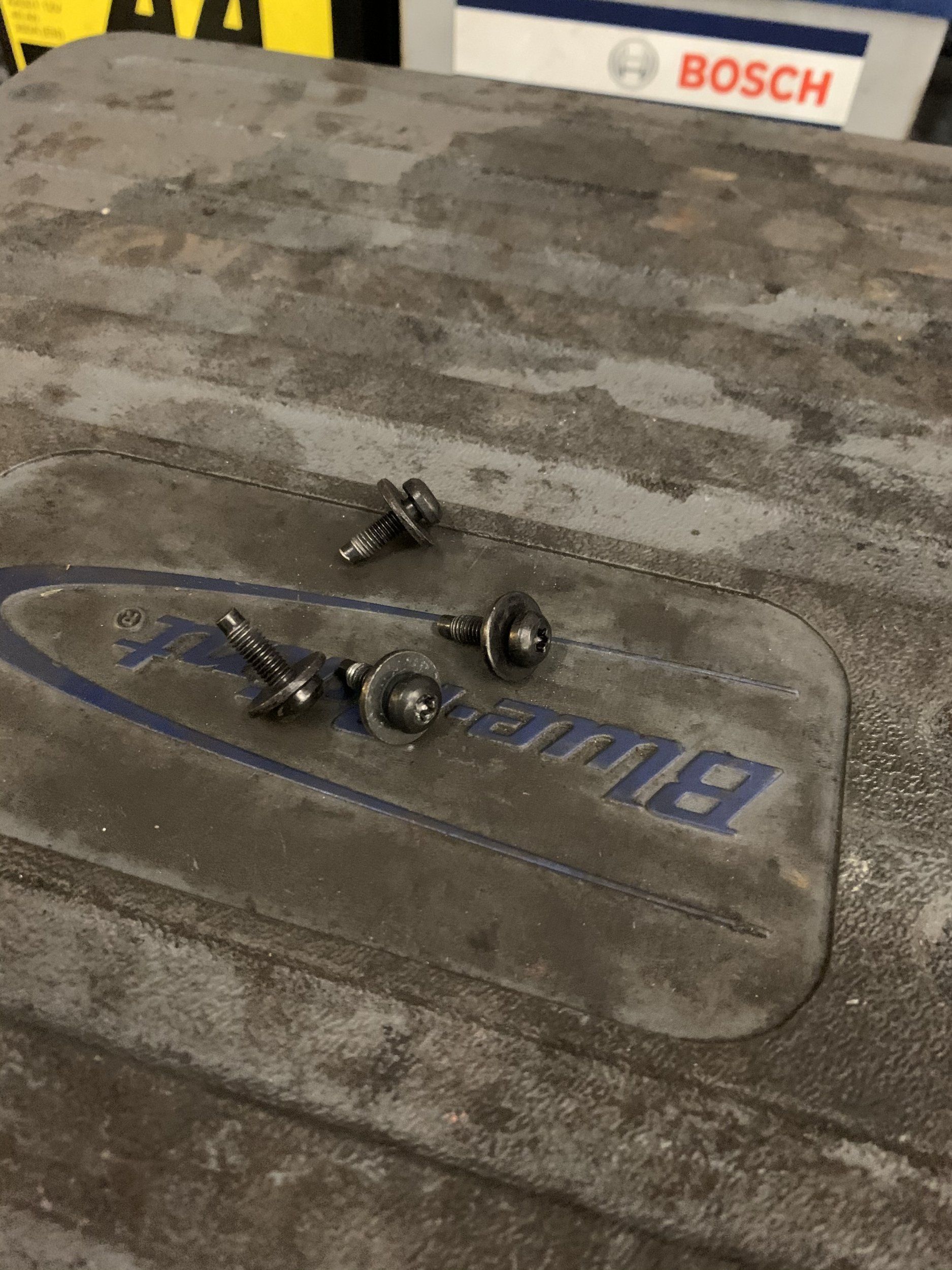

Last time I took the lower dash off, someone had replaced the torx screws with a random selection. Don't suppose you know which screw is the right one so I can replace them? My dash has creaked like hell since, and it annoys my **** off.
Reactions: Sl1ced
Funny you should ask. I think ive got a spare one roling about i the footwell now lol.
I'll take a pic tomorrow for ya.
The speed clip that the screw winds into fell out and i couldn't be arsed to strip it all down again to refit it (will do it Saturday)
I have a few left over from a dash removal

Do you mean these ones
That solves it. I've got a whole bag of these, but they don't have the washers on them.
Thanks for this - all I have to do is stick some washers on and it should solve the creaking dash problem.

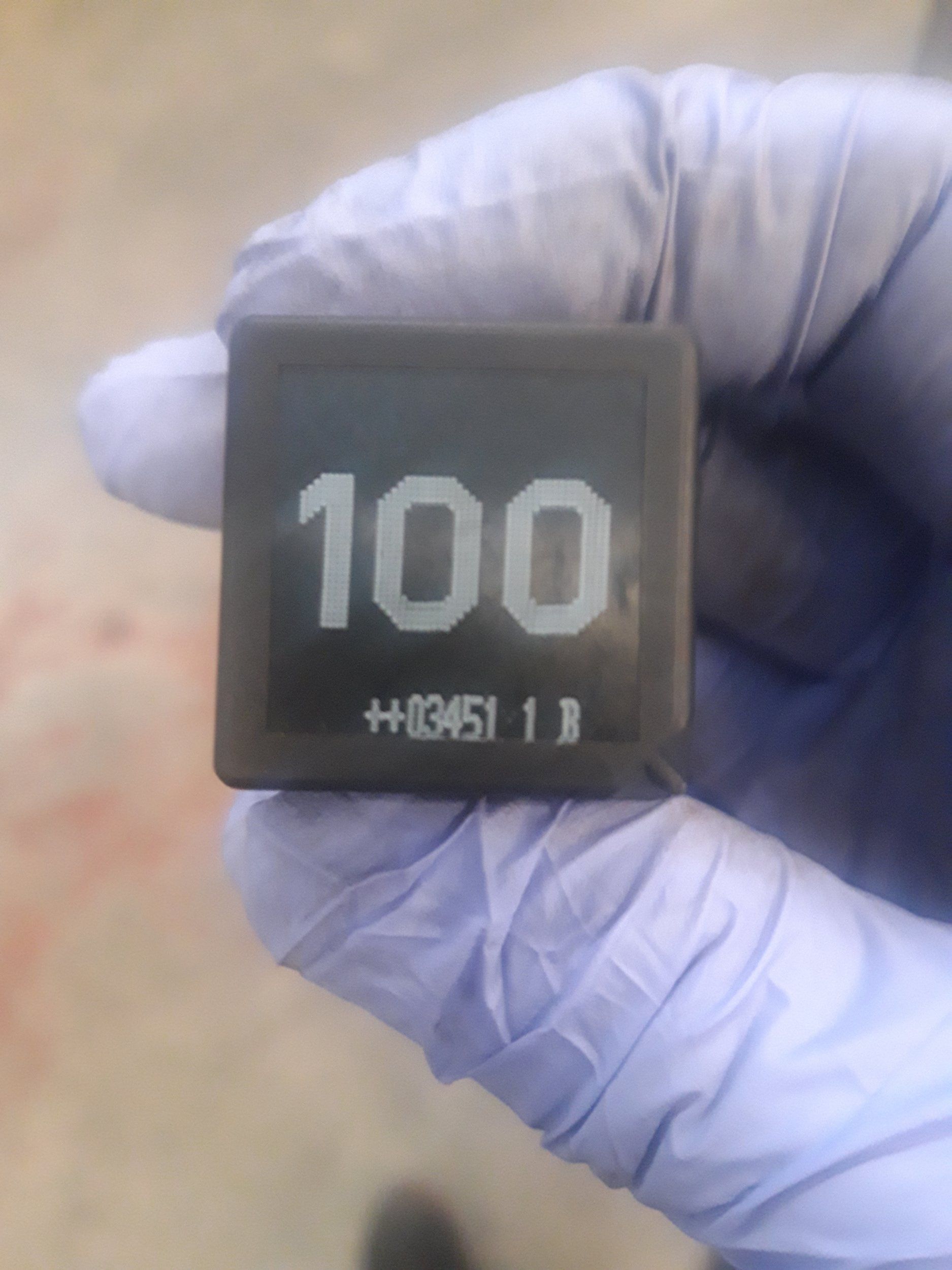

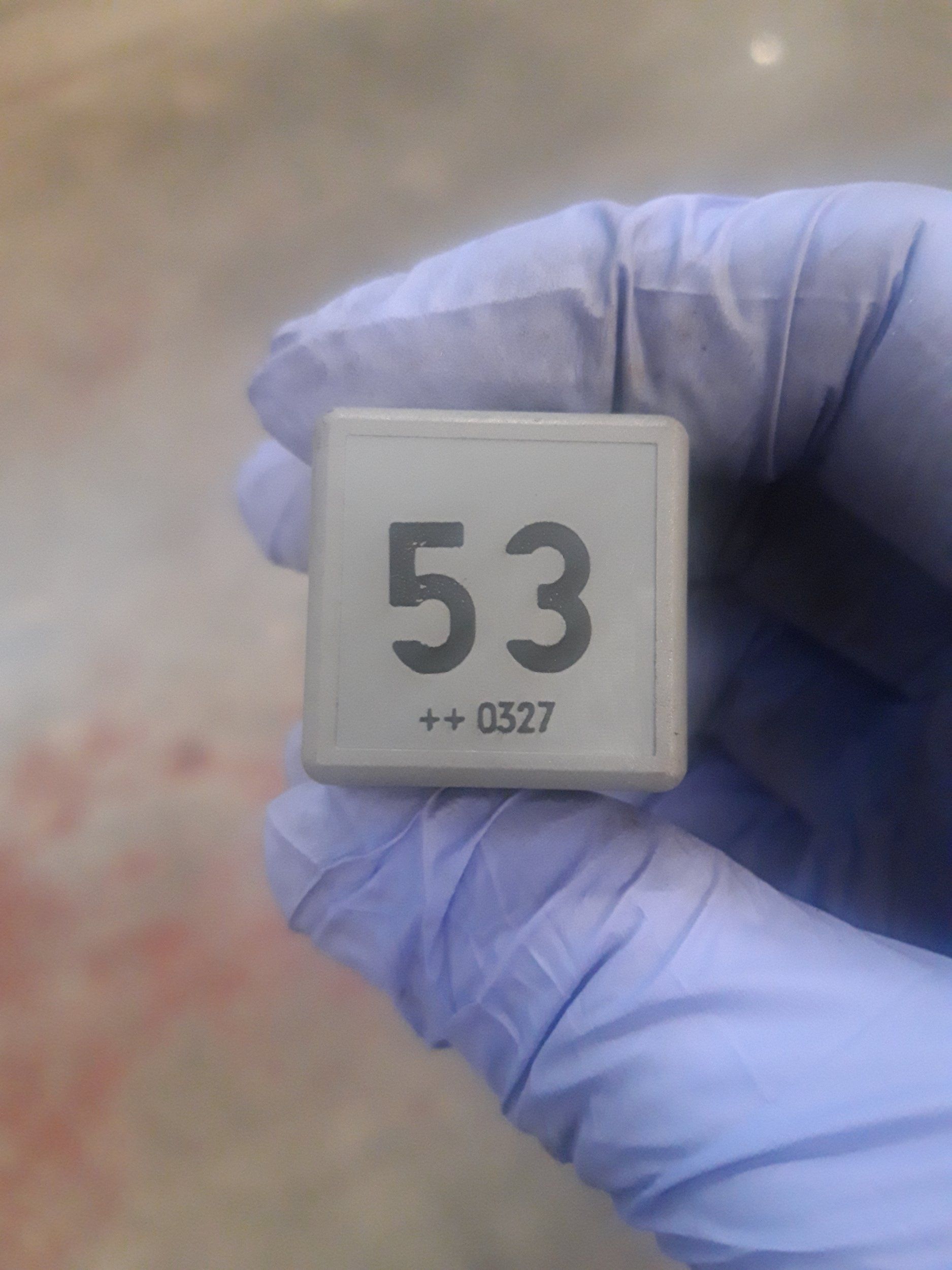

Right, i was out in the car today. The usual problems when i set off then after a few minutes it all started working again. Goes to town for some crimbo shopping and when i get back to the car, the problems are back.
I must admit, im starting to think it maybe a dodgy relay (grabbing at straws maybe).
Anyone know what the relay is called, part number?
Going to ring TPS tomorrow but want to give them as much info as possible to get this nightmare over with.
Its one of these 2...
