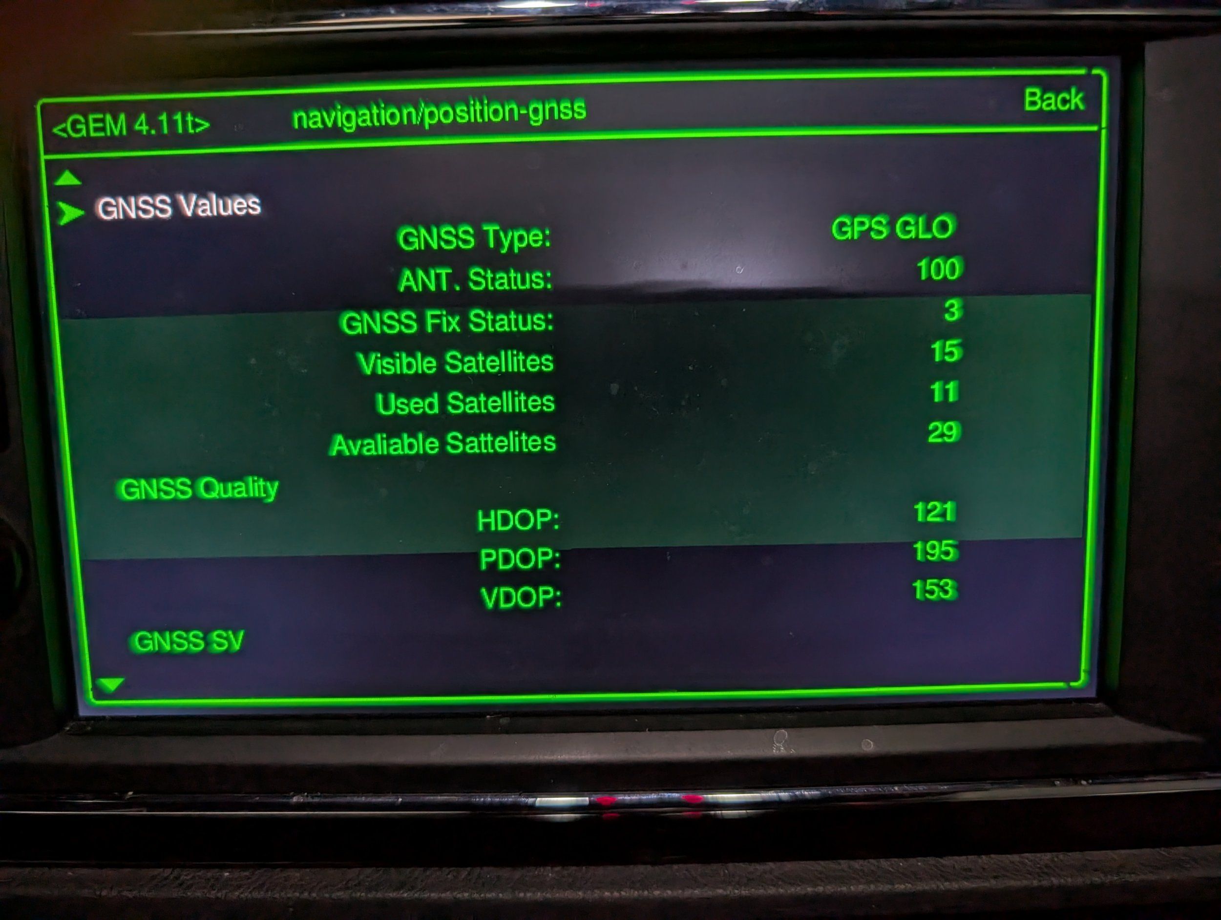

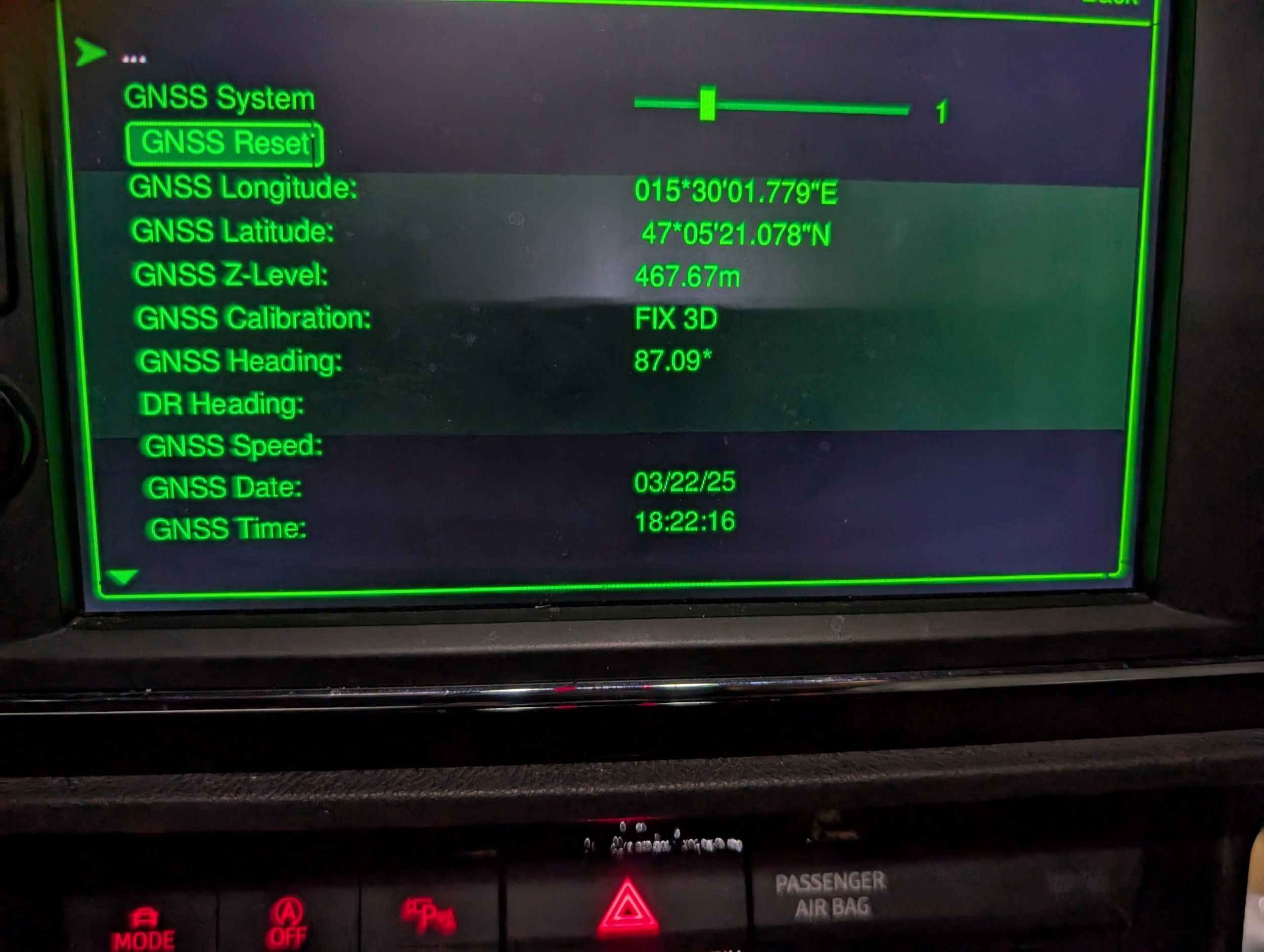

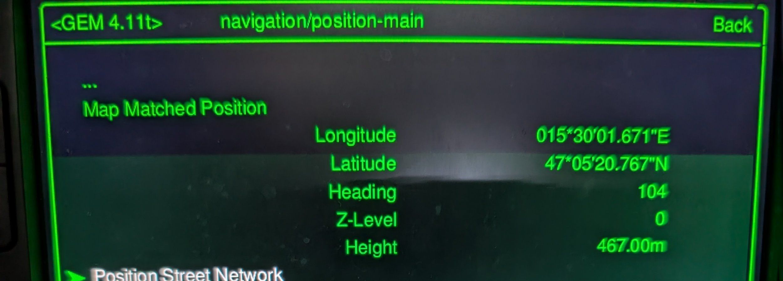

With the help of a diagnostics device, such as OBD11, you can take a look at the live data and check if the infotainment unit receives GPS coordinates correctly (most probably from a control unit for online services, not a separate GPS receiver as in previous generation Leon). This may be a good starting point to investigate the problem.
Ich denke, dass man mit dem MIB2 sehr gut eine Diagnose stellen kann
Green Engineering Menu is not activated by default. To activate it you need a capable diagnostics device anyway.
Sent from my 23113RKC6G using Tapatalk
That wasn't what I was talking about. It was more about whether it could be properly assessed via the Green Menu. Because then, if the situation suddenly requires it, you can check without a diagnostic system.
Yes, I agree on that. But there may be circumstances that you need to be looking at something in or selecting something from infotainment menu and see the data at the same time. That's when the live data in another screen would be required.
