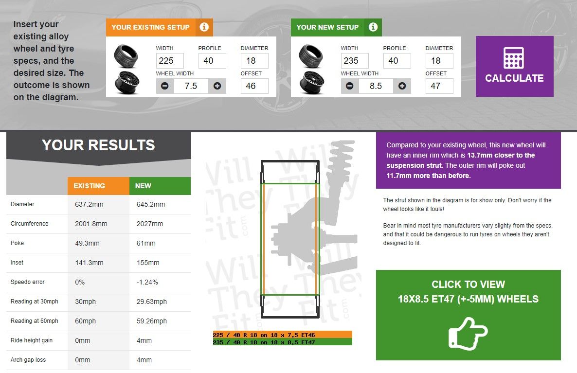

Having a HUGE internal debate as the next mod to do. The two main options are a Tuning Box (several to choose from, but not settled on a supplier yet - either DTI, Burger JB4, DTE or ABT -in price order) or a new set of Mags.
Found some Work EMotion D9R locally - 18x8.5JJ, ET47 and correct centrebore of 57.1. Using the wheel offset calculators on this forum, they sit 13mm further out and 13mm further in than std (7.5JJx18 ET46), and with the 235/40x18 tyres have a minor speedo error vs the std 225/40x18 tyres.
