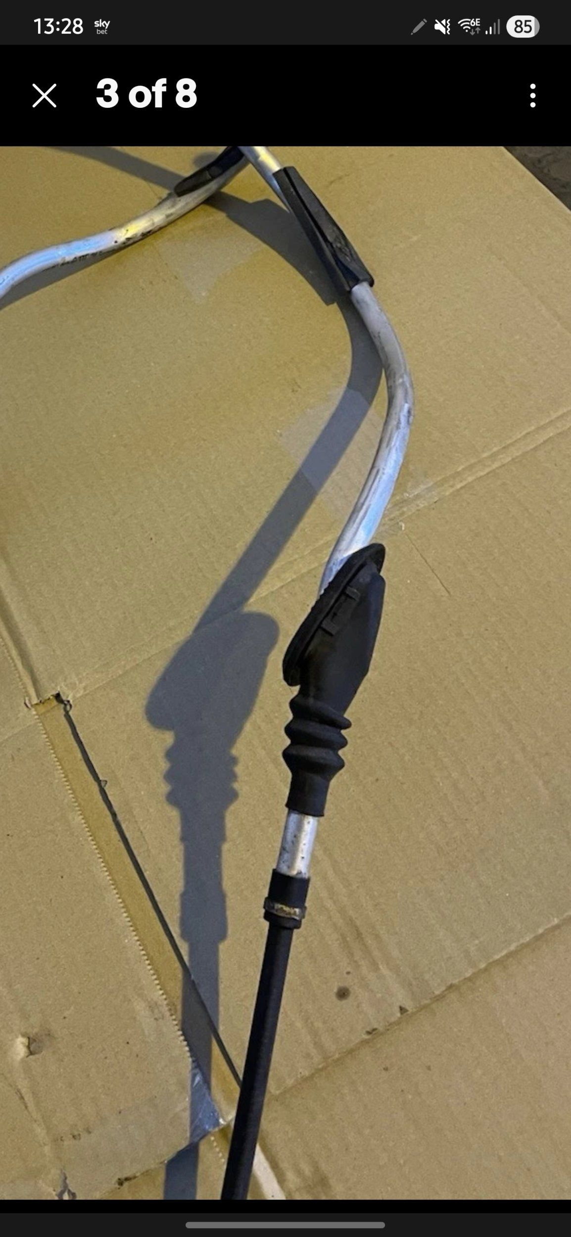

This is the area which I'm having an issue pulling past. This rubber boot area. Does the metal O Ring clip below it need removed?
Great thanks! Seems you need to grip behind the O ring with ideally some plumbers pliers and twist back and forth and it pops out!
Appreciate your reply!
