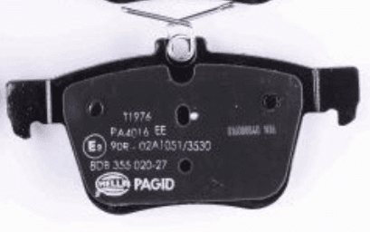

Assuming the Leon has 272x10 rear discs and an 'ATE' caliper then this is the OE pad:
5Q0698451Q
ATE brake system - Pagid friction material code PA4357
Pagid aftermarket pad - Friction material code PA4016 (this is a general aftermarket material used across many of their rear pads)
Ignore the EE suffix, this is just the AMECA code used in the US and is rather meaningless, EE being a lower friction coefficient hot and cold.
This OE pad also uses a fine-blanked back plate vs conventional blanking for the Pagid aftermarket (as well as most other aftermarket).

Regarding backing plates:
This VAG OEM & most OEM pads use a fine blanked steel back plate - which is a more precise blanking process which can hold tighter tolerances and give a better, flatter finish.
Most aftermarket pads - including this one - just use conventional blanking - think like pressing out a cookie cutter in pastry - not as precise or as good finish.
The trouble is that fine blanking tooling is very expensive so you have to have high volume to amortise the tooling cost - fine for OEM where you are churning out high volumes of one part number - BUT in the aftermarket where you have lower volumes and more variety this is a problem.
Regarding friction materials - these really are a secret sauce:
OEM's have hundreds of different friction materials - each one 'tailored' to that manufactures individual requirements following years of testing.
Aftermarket have a handful of different materials to pick from - the better ones have more materials (more than 10) to better match the original material - the 'not so good' ones have 2 (front and rear) or even 1 to cover 1000+ parts!

Yes, that abrasive sheet to 'dress' the discs is no longer a 'thing' Brake discs are machined and required to be ever increasing tolerances (less than 0.010mm thickness variation - 10 microns!) that any disc/pads issues generally just require new discs.
I wouldn't rotary brush the discs -just try re-bedding in process. Something like:
Find a quiet stretch of road and do 10 stops, from 60mph - 20mph at about 50% effort (100% being an ABS stop) most IMPORTANT while doing this is not to come to a complete stop with your foot on the brake.
