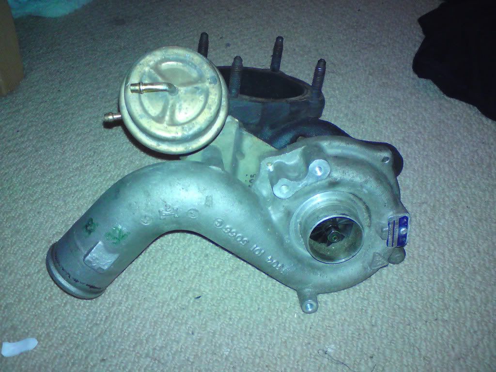

relivent question im going k03s on the weekend i have k03 with two pipes. when i change the turbo what do i do with the pipe running to the sai i think it is? pipe thats not needed

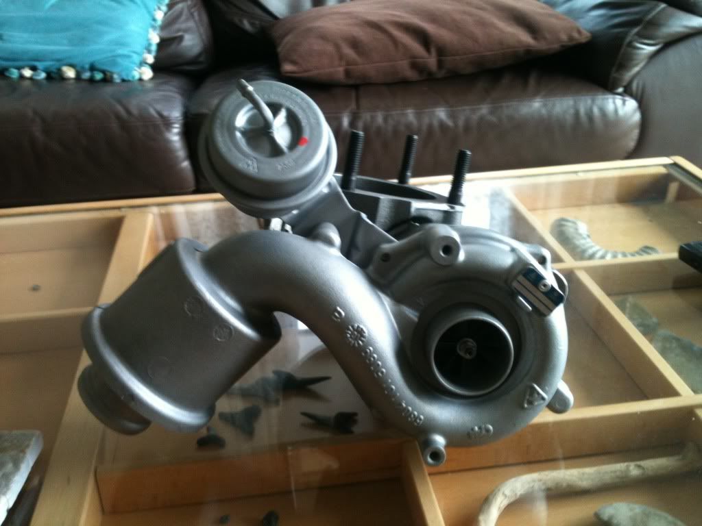

k03
my new k03s uprated actuator and uprated thrust bearings. safe 1.6 bar boost.
