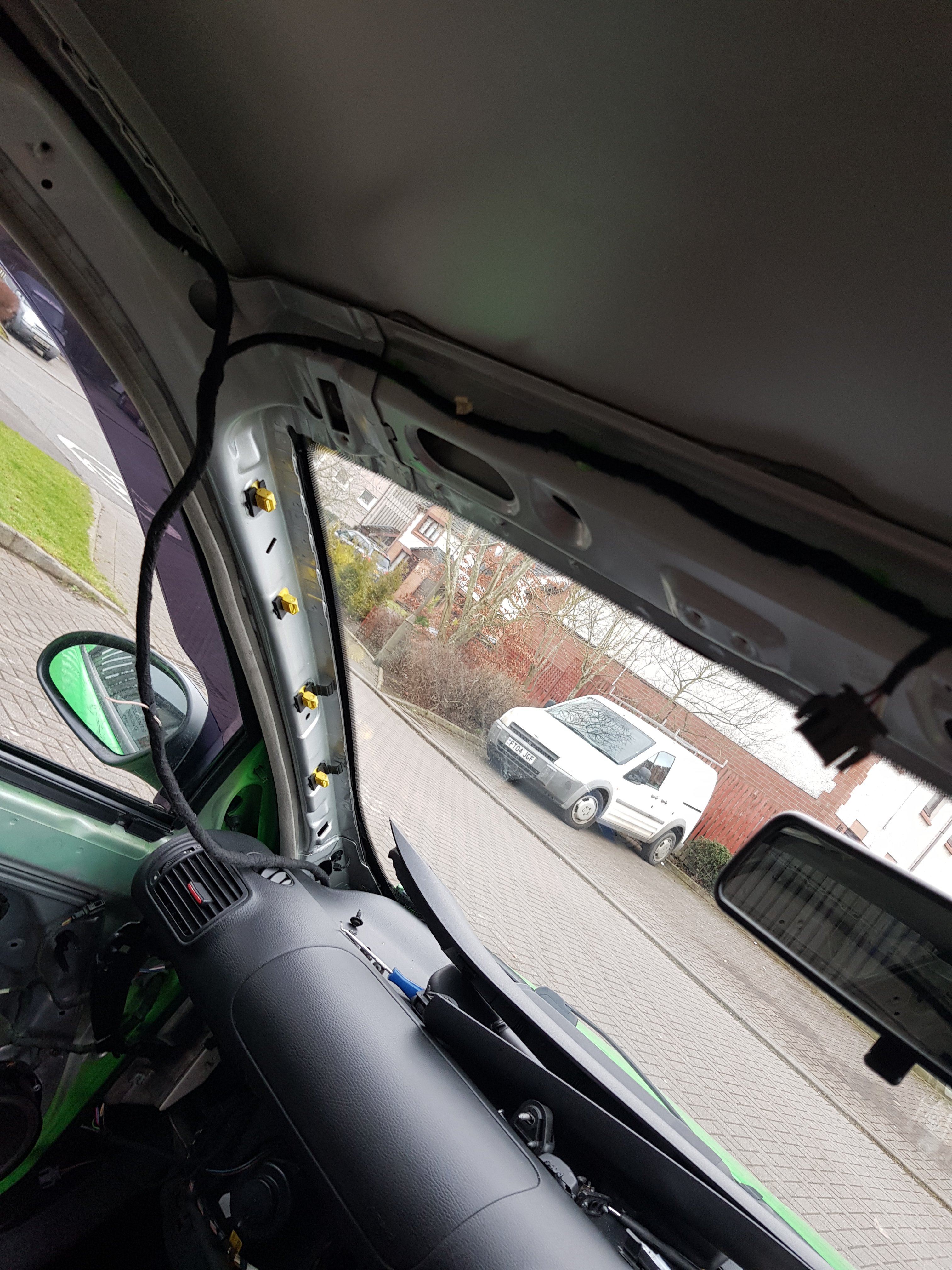

Thank you for reply no its one single loom with no plugs nothings tucked away at all. Attached image dont know if will work but can find a plug all runs in behind glove box to big ball of wires.

Having stripped out many Leon's I can confirm that if the car didn't come with illuminated sun visors you won't find a loom hidden away anywhere.
Many early Leon's didn't come with them and its predominantly the facelift Cupras & FRs that received them from the factory.
These cars of course came with grey headliners.
Not many Cupra Rs came with them fitted and they were strictly reserved for the very latest ones eg 05/ 55 plate.
Obviously the Rs came with black headliners, lights & plastics.
These are bloody hard to source now as I've tried on numerous occasions.
The actual vanity lights can be found from few other VAG offerings but the microswitched mk4 Golf Anni and Cupra R sun visors are incredibly difficult to find in good condition and / or not ridiculously priced.
It look me a very long time to find some along with a black centre visor to go into my Cupra R.
As for the loom, you'll need to chop it out of another late Cupra or FR and tap into the existing interior light loom.
