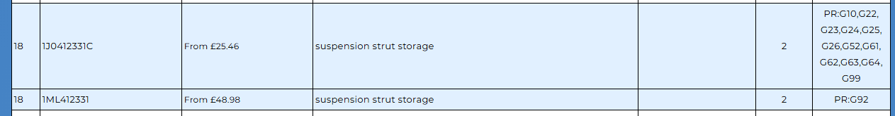

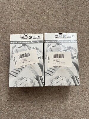

The latest part number for PR: G92 was 1ML 412 331 - but as far as genuine VW Group parts stocking is concerned, that number was dropped 01/02/2022.
So maybe search using that latest part number matching aftermarket offerings.
Hi. On this link: Strut
I can't get them from EBAY, they doesn't ship to my country.
Offerings from "performance leaning" aftermarket suppliers should be made of similar ie harder "rubber" I'd hope.
Even aftermarket(performance/standard) has both 1ML 412 331 and 1J0412331C OE number, I will get cheap one with 1J0412331C and see if they fit, if they doesn't fit i will try to get 1ML 412 331 used or mine repaired.
Difference is 1J0412331C Durometer 50 - 55
1ML 412 331 Leon Cupra R = Durometer 80
