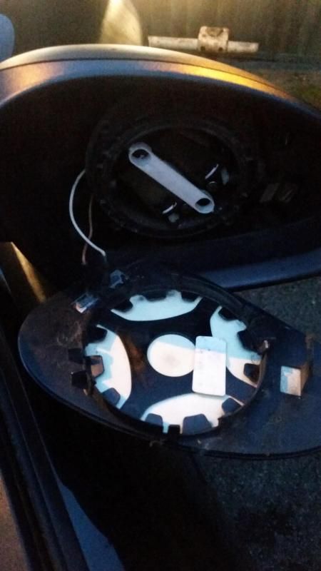

As above.
checked all relevant fuses etc.
Pulled the mirror glass off and this is what I have
they don't ever get got.
Obviously I have the switch on heat mode too.
Is this glass even a heated glass?
I know the plugs are there but it doesn't look like there's anything more though there's sticky pad there so can't really see. .
Cheers

I think the mirrors can give up after years of use so you might just need to get a new one, £50 seat or £12/15 ebay.

The actual voltage to the mirrors is controlled by the Central Electrics Module. You can program how long the heated mirrors are activated for through VCDS (using my guide - http://www.seatcupra.net/forums/showthread.php?t=410151)
They only work from the time the ignition is switched on and the timer shuts them off. It restarts after the ignition is switched off then back on.
It could be as simple as the contacts in the mirror being faulty and requiring a replacement to the timer isn't set long enough to warm the glass.

You can still use VCDS to check to see if they are activated long enough, usually 2 minutes is plenty.

I burned out my heated mirrors out on the B5 Passat simply by leaving them on and expecting them to only get powered when the rear window heater was on for that car - WRONG! If that is what has happened to your mirrors, they will now measure 1.2K instead of a few ohms - and will look the heater tapes will look very dark or black.

Looking at your picture, that one does not look black/burnt, though as I said, once you have checked the resistance across them you will know if they are O/C or not, the high resistance values I got were due to the carbonised sticky pads not the copper heater tapes. VCDS will not know that they are O/C as it will still see some current draw, when you unplug them VCDS will log that!
Ah I see.
All others I've had I can see the elements on the back of the glass but not this one.
I forgot the multimeter but will do it tomorrow :)

Just one thing wrt the mirror glasses, heated mirror glasses will always have a connecting tag, or really 2 tags on the "mirror assembly" ie the part that you can remove/replace when you break a mirror, the 2 wires you found plug into these 2 connecting points - are there any connector tags on your mirrors?
Ok all sorted, appears they are now linked to the rear de mister since the BCM was reset, apparently this is a setting in VCDS that can be changed. Worth trying putting your mirrors to the heat position and putting your de mister on if they don't work on their own.
