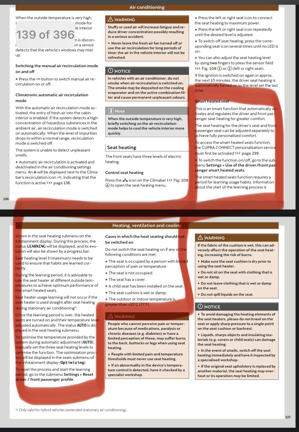

I have the Formentor for 3 months now it still didn't learn when to turn on heated seats. Is there a way to just make it automatic based on the temperature outside?
There is a setting in the menu to set the seat to “on” to a set temp, mine was set to 5 degrees. Can’t recall where it was but I did that on my Formentor when I had it.
Reactions: tzuicomicina
Only did reading the manual excerpt above did I realise the learning function only picks up use of heating level 3. I tend to use 3 until warm then drop to 2 or 1, but it never seems to 'get it' and starts on 2 or drops to 1 too soon. Found it useless and have gone back to manual (i.e. stabbing at the heater slider with the two finger salute).
