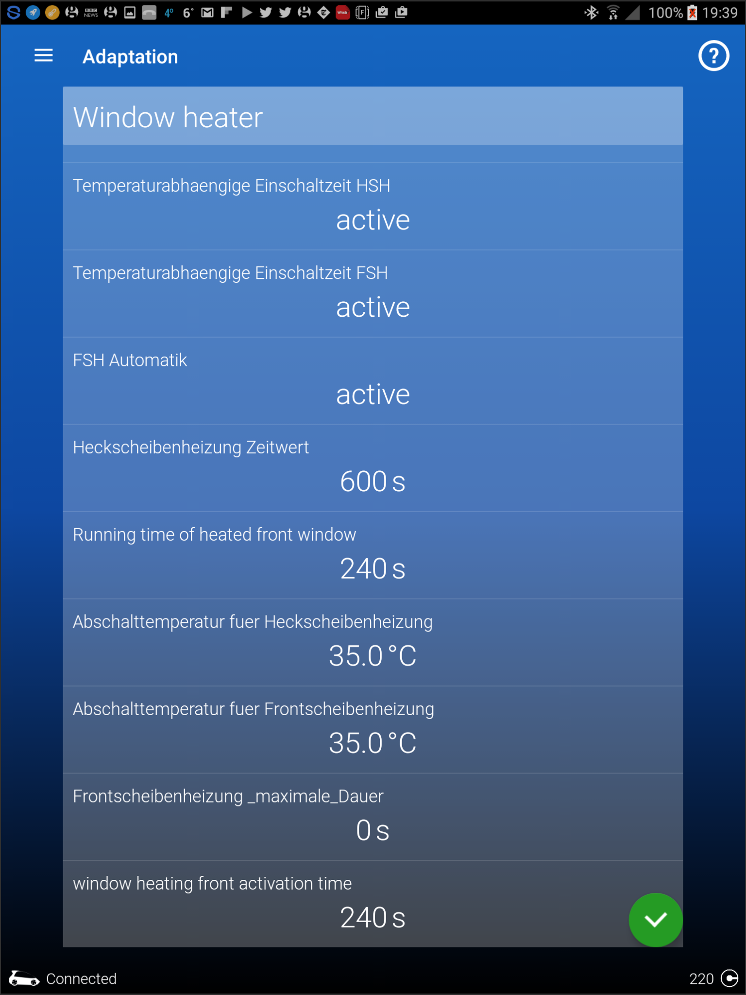

On the post my19 and above you have a display on the info screen you can swipe too, before you hit the setup button on the ac (you can still get at it that way if you have the latest infotainment firmware), the screen has a coil on it. At launch there were lots of questions about it. Basically you dont touch anything to enable it, its automatic put the windscreen fan on full blow, back windows as well. After a while it clears it and cuts out.
I extracted the settings out of it with Obdeleven to resolve how it worked.
  • Front running time of heated screen 240 seconds, shut down at 35'c.
  • Rear heated windscreen running time 600 seconds, shut down 35'c.
Basically, it's front windscreen blowers on plus heated rear, have automatic windscreen set to on, it defaults to that then it runs for 4 minutes / stops at 35'c which ever occurs first. Rear 10 minutes / stops at 35'c. You don't need to touch the front windscreen menu option, everything on the left blower button.
I spent several months in 2016 fiddling with it since the published manual never covered the working of it, was hearsay from the dealer. Reality is cold day, bash the blower on and it takes care of itself. No indicator light. You do see the wires in the screen if fitted but you get use to it. On an icey day you just get left with the sides to defrost if you have heated windscreen and side mirrors. :).
Obdeleven screen shot attached for info, some in English and German. Decode with Google translation image.... useful with the Obdeleven;).
