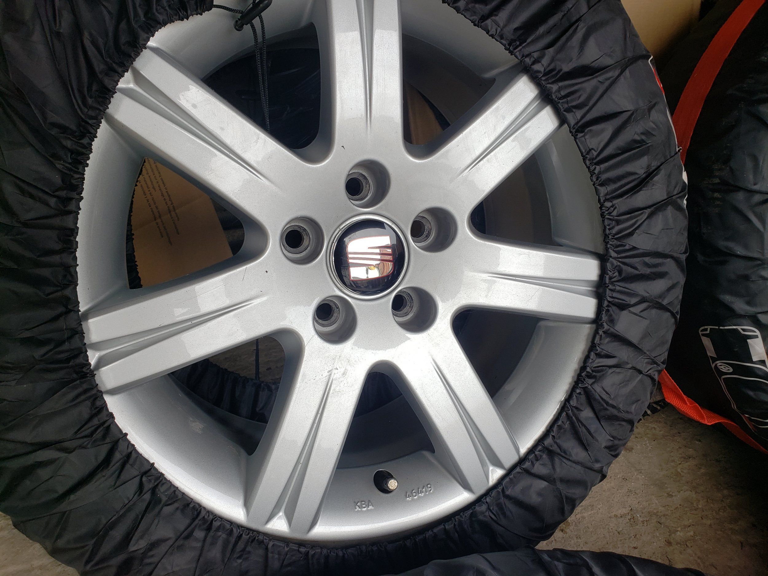

My car came without winter tyres, and it’s almost time to switch to those. Also I don’t have any other rims I could use, so I‘m looking for a set of 17 inch tyres. My summer tyres are 225/45. Should I go for the same size in winter edition, or slightly thinner? I was thinking 205/50 maybe. Rims shown on the picture below, I have no clue whats the ET number on these.

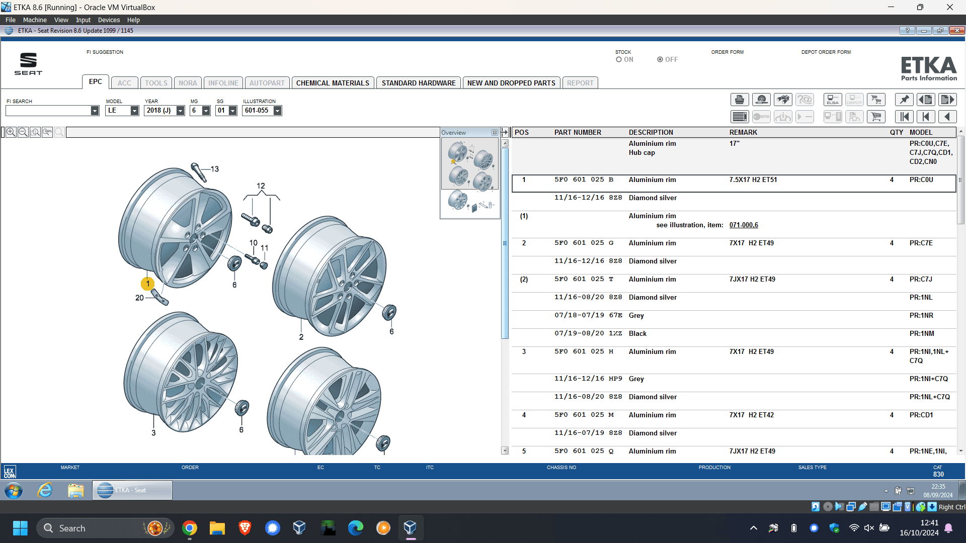

Your rims are 17 inch diameter, 7.5 inch width, with an ET 51mm

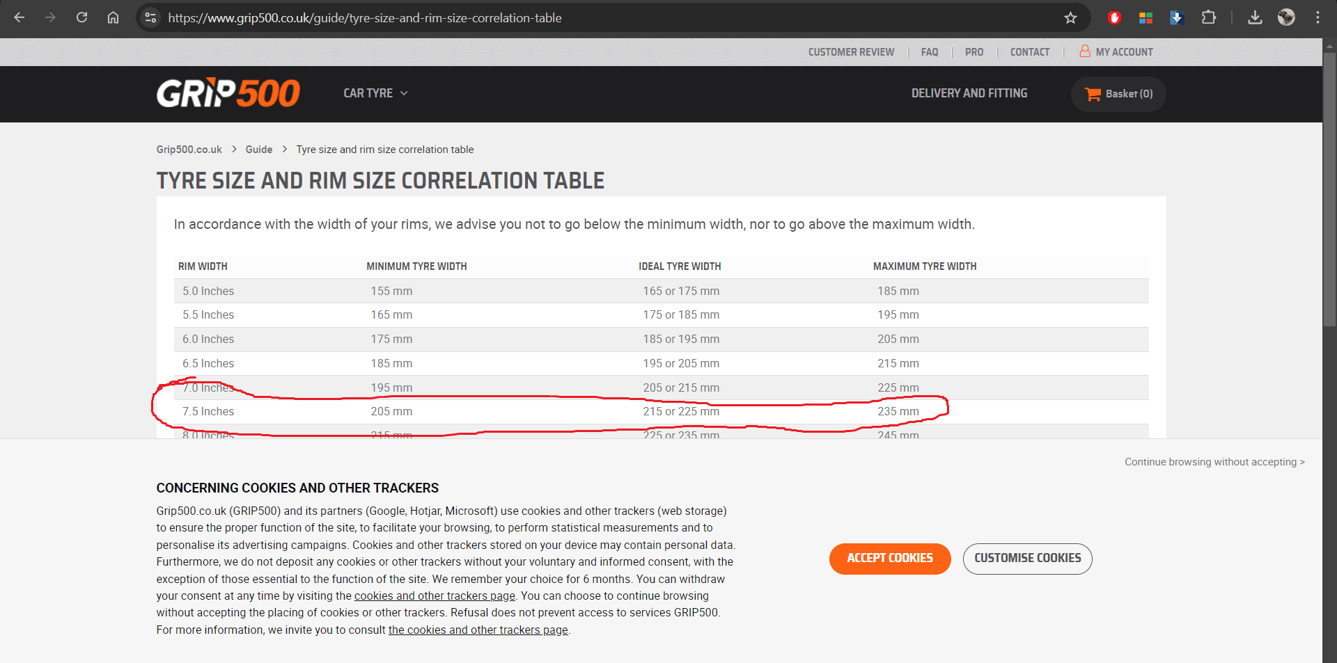

What you need to bear in mind is that on those 7.5inch wide rims, the ideal tyre width is 215 or 225mm, with 205mm listed as the minimum permitted. Many will argue saying they have 205's on 7.5, just quoting what the recommendations are.

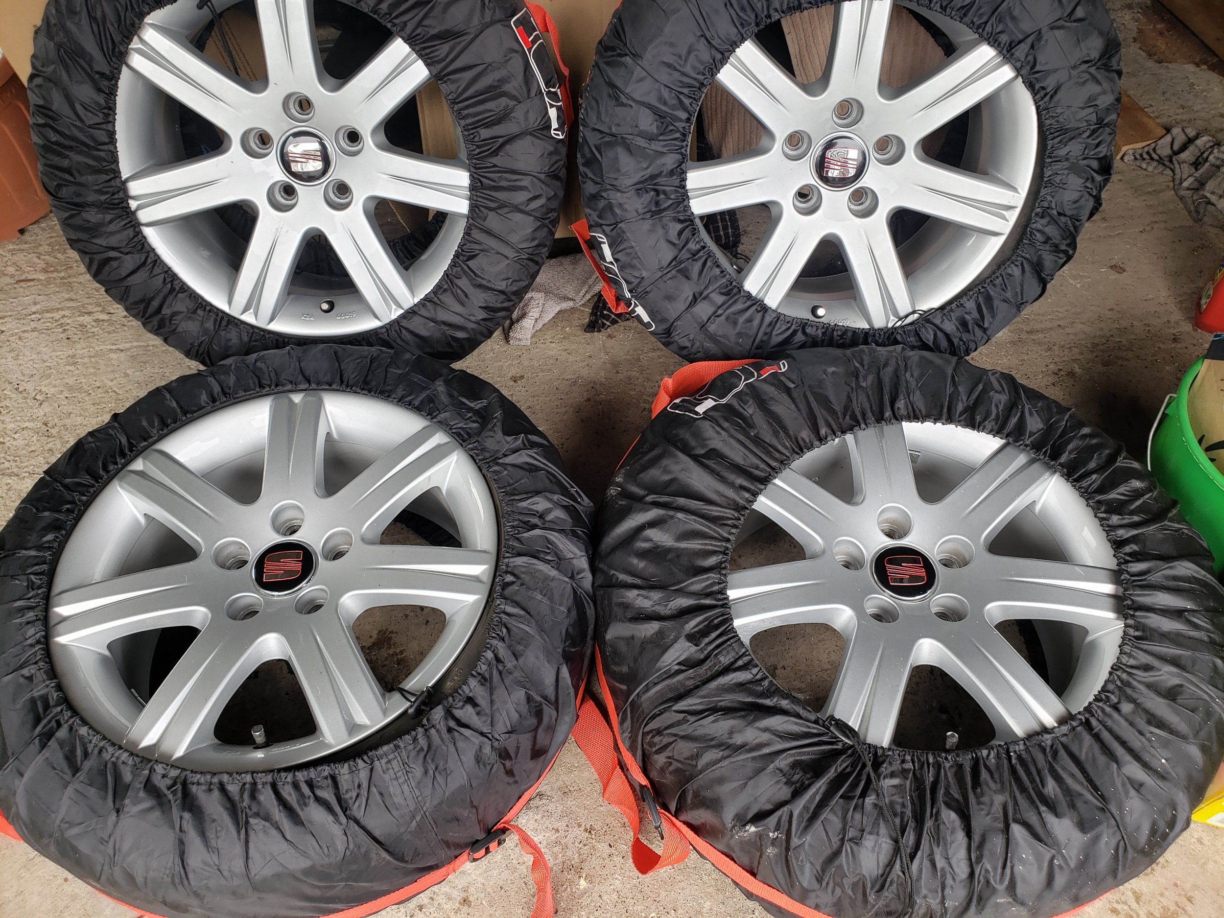

Your 17s will be fine with winters just swap tyres for the same size. I ran that same wheel with 225 45 17 winter tyres on my mk3 cupra st. It rode very well.
