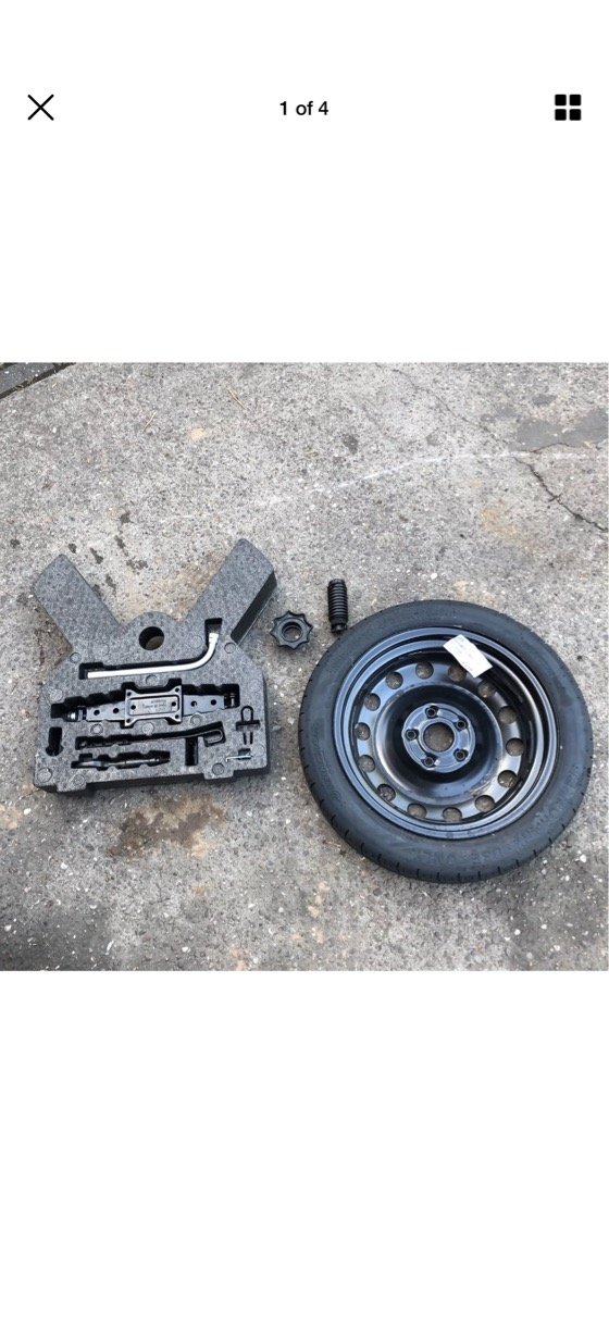

Yeah, sadly the Carbon Edition didn’t get the Carbon fibre spoiler or the R Grills (although I had the grills fitted a month after the car just dropped coppered)
Will try get a photo, but it’s the one where the tool kit sits under the wheel, not in or to the side of it.

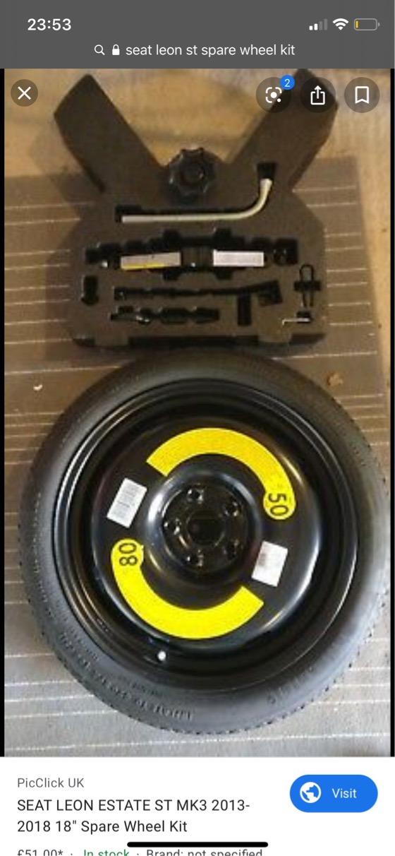

These are the ones like mine. But I cut a lot out of each of the arms that stick up on these photos and then slotted my torque wrench box in. The pump just happened to still fit nicely in between the torque wrench and the boot itself
