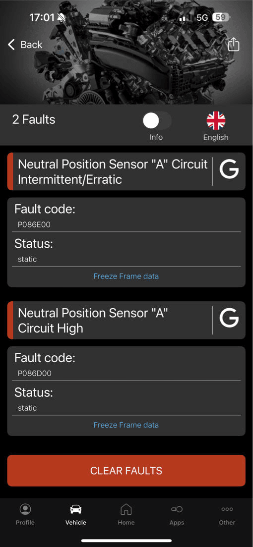

Depends on what fault codes you have please share what codes you have.

Not one I have any experience in but I would not have thought a battery replacement would cure this.
i saw this article (granted for Audi) but a lot of the web pages talk about wiring / sensor issues.
Hopefully somebody who know these codes can confirm

Because I have replaced the battery but do I need to code it for the faults to now go away
Yes I would always code in a new battery, this tells the charging system you have a new battery and therefore charges (over time) differently.
With regards to the serial number all that is important is that it is one character different to the current one so just add 1 to the number you allready have and it will be fine.
As per my previous post I dont know this issue but suspect that once you have coded and tried to clear the errors they will come back as there is a wiring problem and a new battery wont help, but hopefully somebody who has dealt with this issue before can confirm.

Okay because I’ve had it coded and the faults are still showing up so at this point it’s got to be a wiring issue
Or it could just be a sensor that has failed.
Even if the battery were incorrectly coded, it would be the smallest problem. 98% of the time, the error has nothing to do with the battery.
