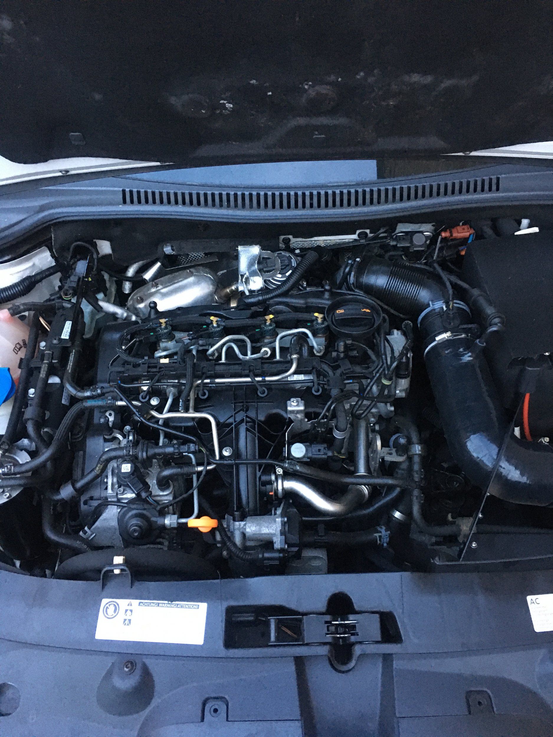

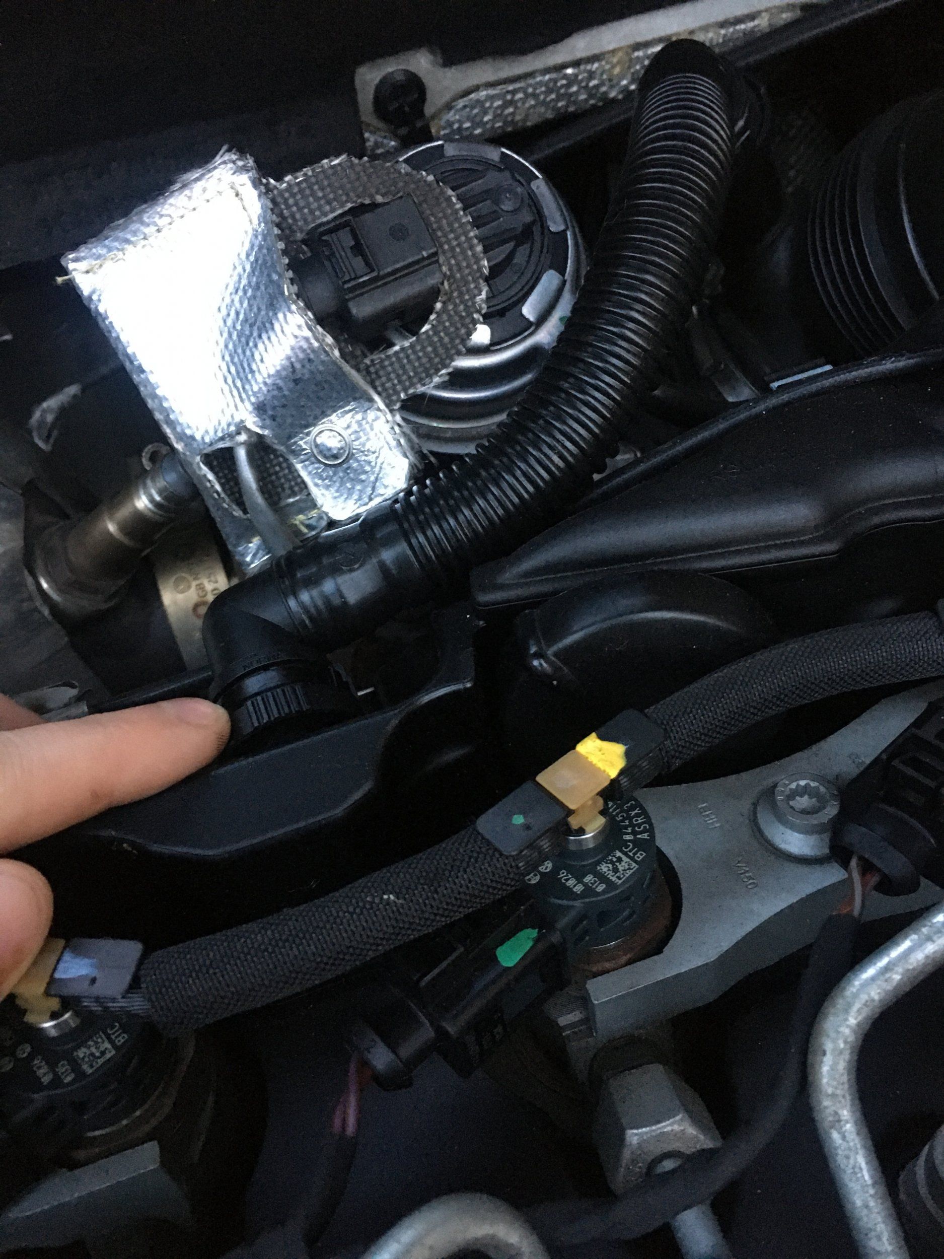

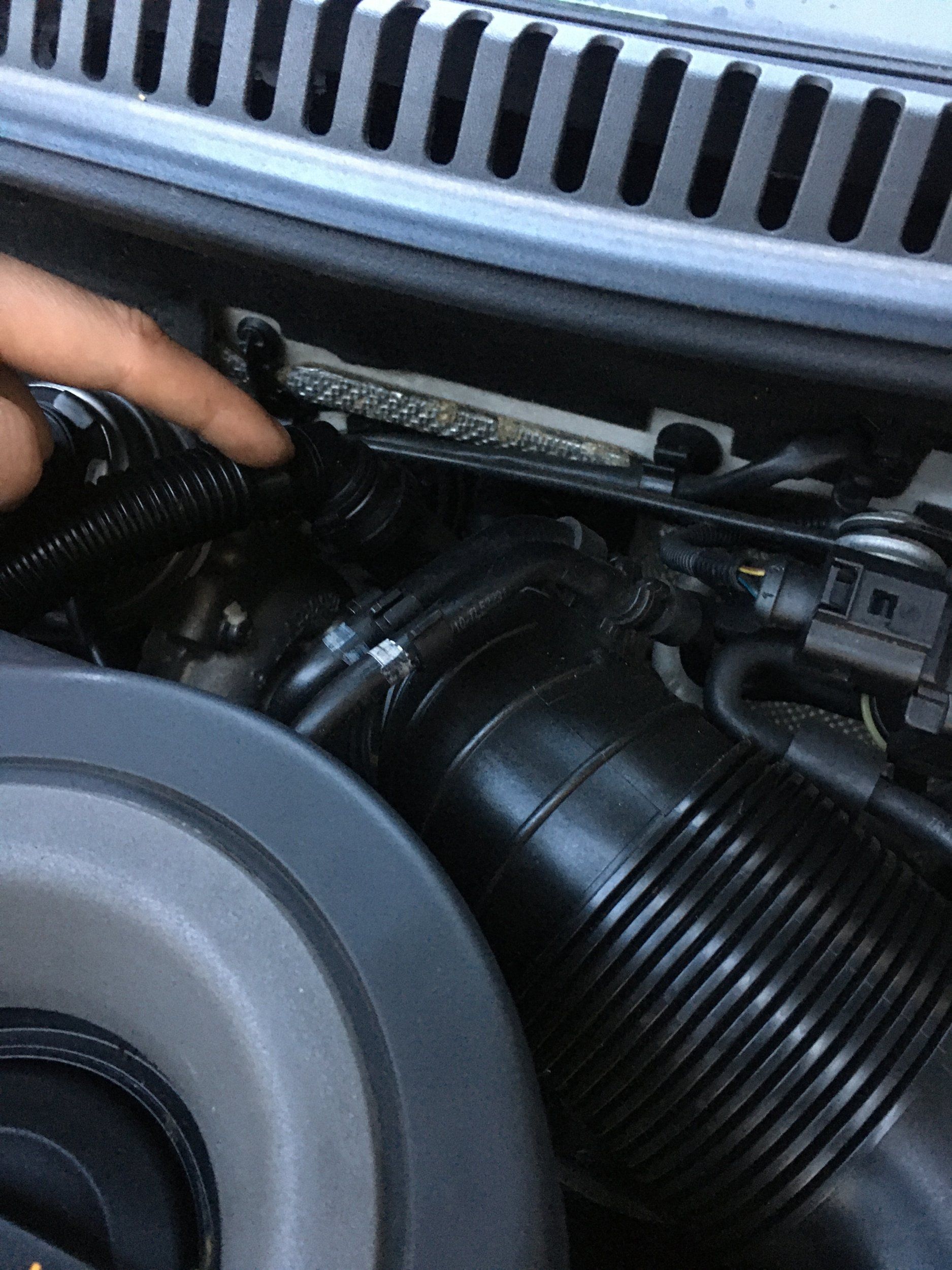

Hi I’m thinking of installing a catch can on my 2011 seat Leon fr 2.0 TDI CR engine code CFJA but I’m not sure where the pipes to attach the catch can should be?
I think I could be here (see pics) but don’t want to install it to the wrong place?
Anyone fitted one to a CFJA? If so I could use some guidance?

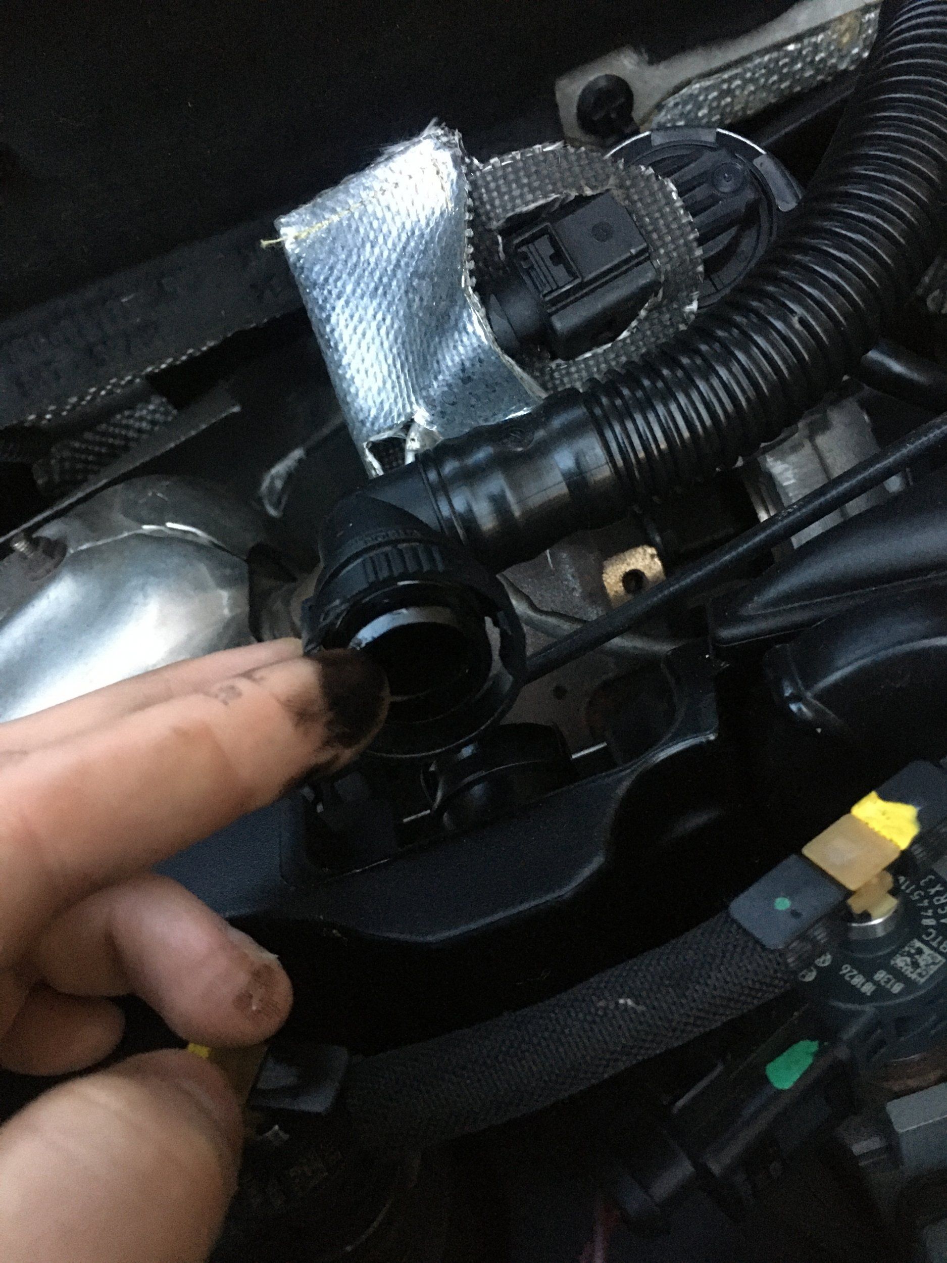

Well it smokes quite abit after being driven hard, and if this is the correct pipe it’s got oil all inside and leads to the intake, so if I could catch that oil before the intake I’d be better off?

I suppose so but that pipe is full of oil so I’d like to catch it before my intake gets it, it’s not a track day car but I do like to push it, can you confirm if this is the right pipe?

Only after it’s had a really hard run doesn’t do it often, I assumed it was high crankcase pressure putting oil into the intake via the breather? As that pipe is coated in oil hense the catch can? Is this the correct pipe?

That’s why the breather is there in the first place to prevent the pressure getting too high, I’m just concerned about the oil getting blown into my intake and trying to stop that from happening
