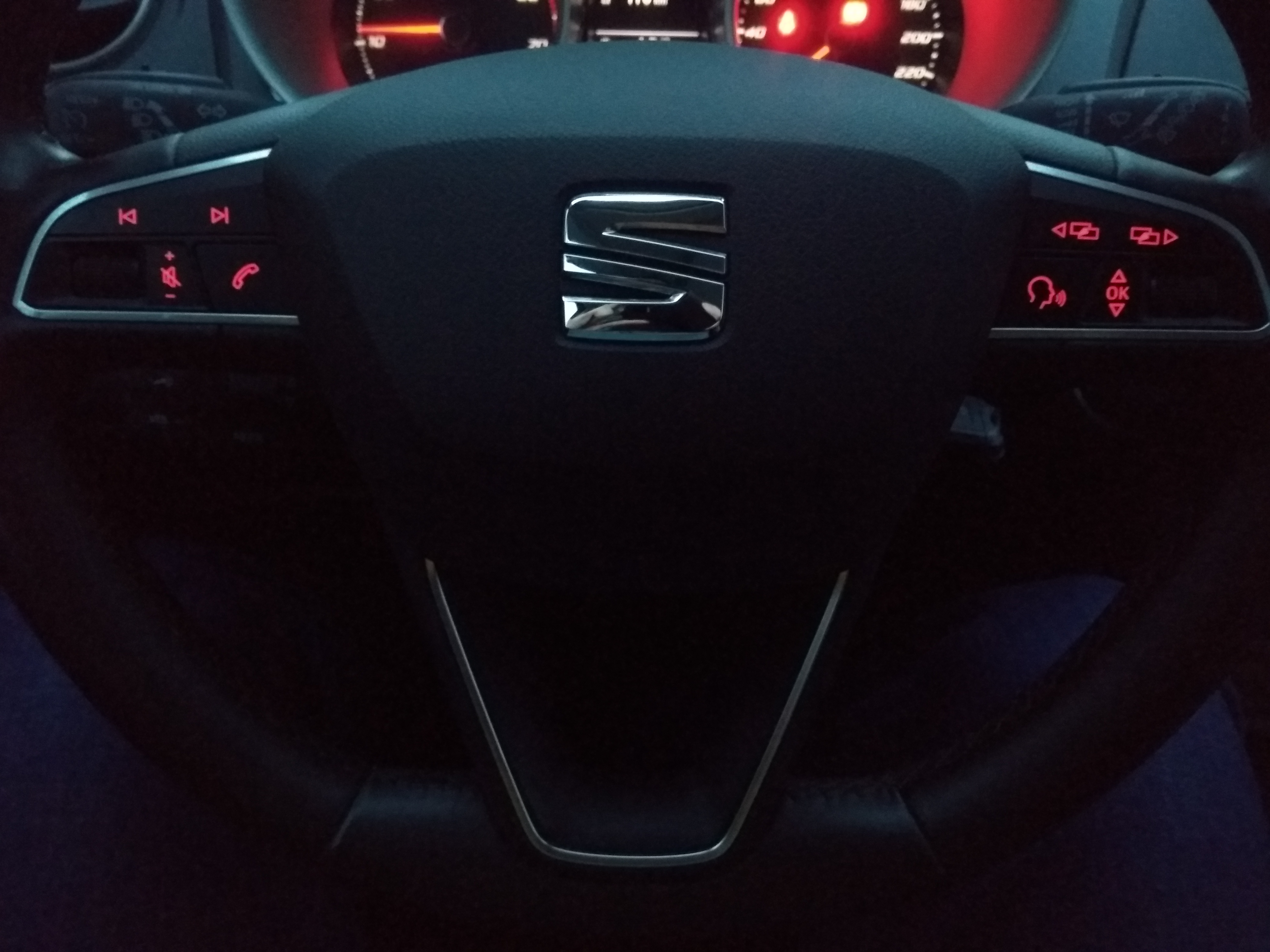

Hi,
if someone is interrested about MFSW for Ibiza 6J, I have tried new style steering wheel and its working fine in Ibiza 6J PQ25 platform with factory installed BCM 6R0937087H. Buttons backlight is working too.
You need to
1. replace only theese parts:
5f0880201J AAP / 6f0880201J AAP - airbag and mf buttons cable (orange)
7n5419091D - steering wheel
2. add two wires to steering wheel coil for 12V and LIN BUS
3. connect 12V cable to 12V from ignition switch [EASY]
and LIN-BUS cable to BCM [HARD JOB because there is little space arund the BCM under steering wheel]
4. remove original multi function module otherwise radio is possible to control only via multifunction module.
5. VCDS coding to enable MFSW
There are too much installation manuals for POLO 6R which have similar bcm and mf coil so it isnt needed write wirring installation manual in this thread.
