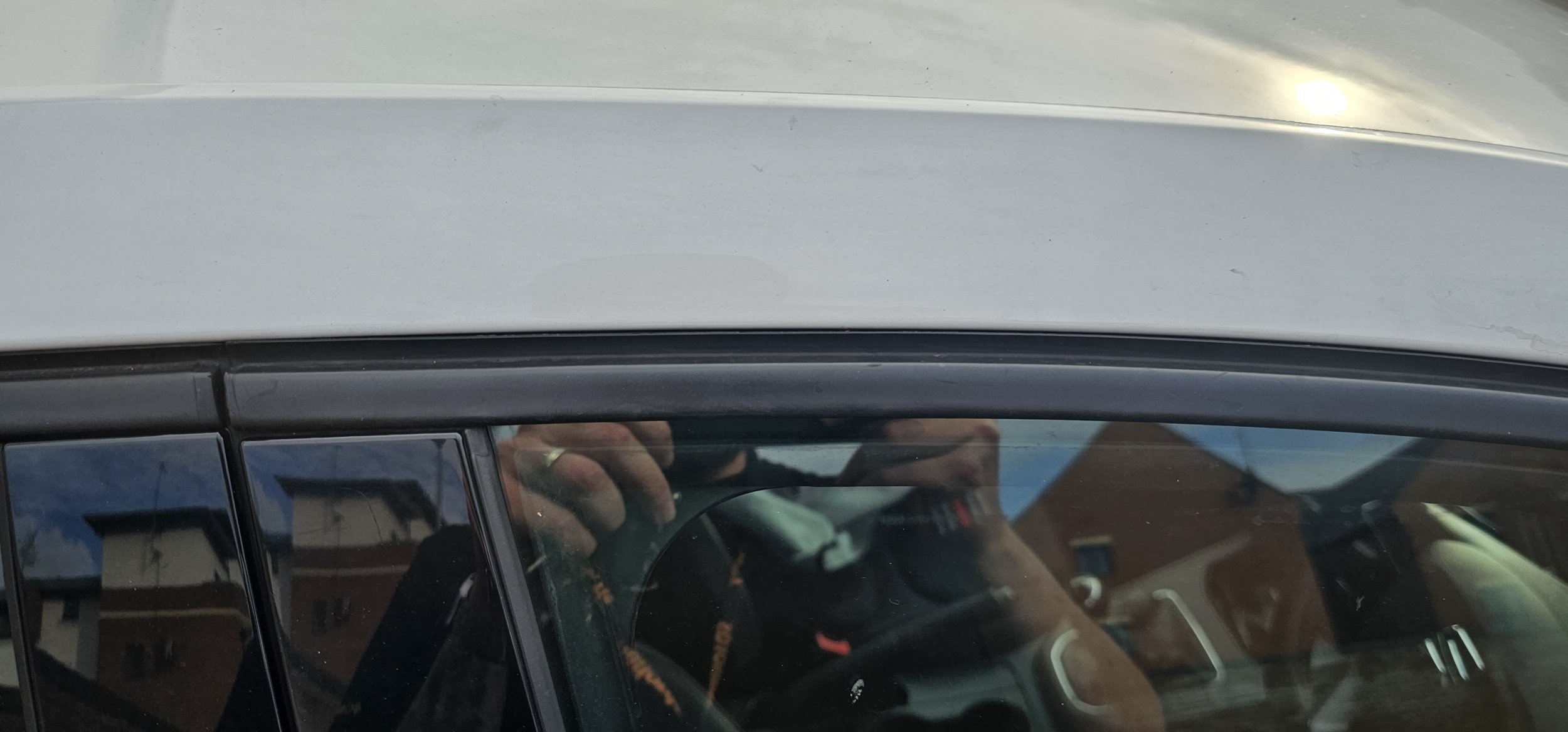

I have an ibiza fr 2020 that let's in water from the top of the drivers side door, its not terrible but still a concern. I think the issue lies with the trim at the top. Pictures attached. It comes slightly away from the bodywork at the top.
Picture 1 is the passenger side
Picture 2 is the offending side
Slightly difficult to see but it you zoom in you will be able to. It looks like in picture 2 that the door has dropped slightly, looking at the middle pillar. Any ideas of a fix or what to do?
The best advice I can give is to go to the dealer and they will slightly loosen the screws that hold the door and raise it a little, as you have no experience it is better not to touch it.
