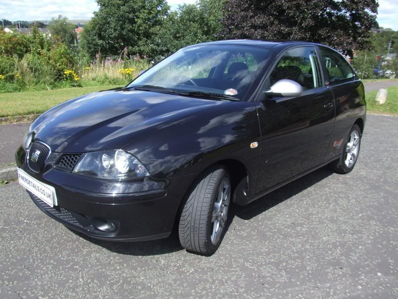

Below are pictures of the car before I started:

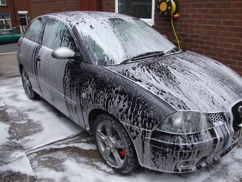

With the wheels clean, I then started the process of cleaning the paintwork and upper sections of the vehicle. First I pre-soaked the upper section with snowfoam. I then applied a second snowfoam layer to the car, and with a Cobra washmitt and the Pinnacle Bucket with grit guard and dolly.
