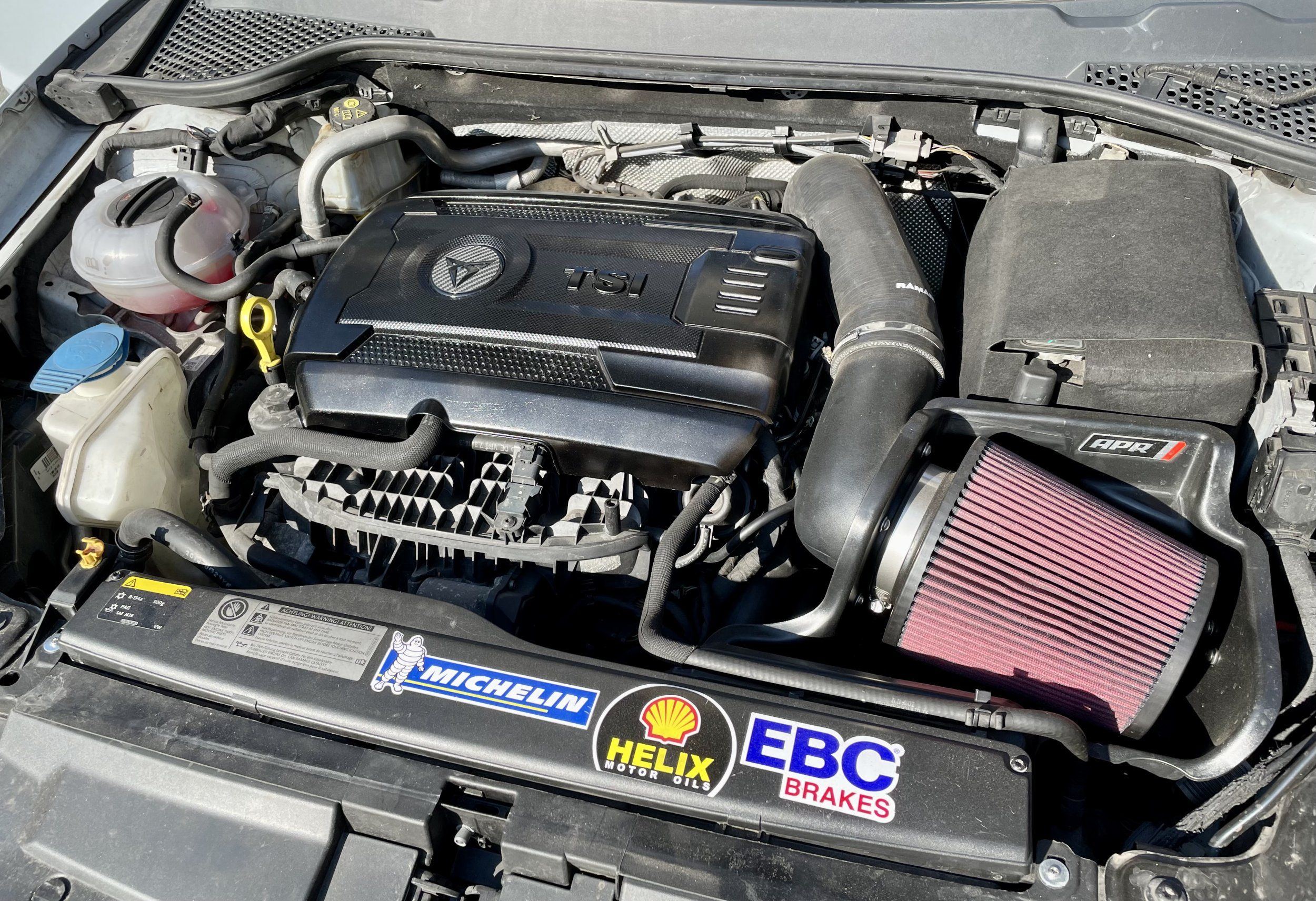

This is on my Leon Cupra 280.
Reactions: LGHN-FR
That looks great mate, thanks!
I’ve been told i might benefit from fitting a cold air intake pipe below the actual filter. Is this something you’ve done?
It does say that the heat shield around the filter creates the barrier keeping low temp from the factory cold air intake, I thought that the factory cold air intake would be enough but now I’m not sure ??‍♂️
Nah, I haven’t installed a pipe below the filter. Just the APR cold air intake filter, larger Ramair intake hose and Ramair turbo inlet elbow.

Not sure you'll find too many people that have done this, as on a TDI it has absolutely zero performance benefits - literally all it will do is allow a bit more intake/turbo noise to escape. Which is fine if you want more woosh noise, but you won't get any extra performance at all

Mines stage 1, but 2L petrol. I installed mine more for the cold air improvement over hot air, and someone was selling one on here cheap! The noise is nice, but don’t notice it all the time as it’s on the passenger side.

On the petrol cars, yes it 100% is a worthwhile/required mod - but on the TDI it makes no difference.
A stage 1 map (which is what I have on my 184) should take you to circa 230bhp, at which point the fuel rail and exhaust temperatures become the limiting factor. You can't remove the DPF (instant MOT fail) to improve temps so that's that - no stage 2+... and according to a lengthy video (worth a watch, as it's the same engine) by darkside developments on the Golf mk7 GTD the stock airbox isn't a limiting factor even at 300hp
So absolutely go for it for noise and looks (I have a carbon intake on mine into the stock airbox, purely for looks), but it won't actually help with anything

TDI air filter 5Q0129620B is the SAME as used on the 1.8 & 2.0 petrol's! if it can flow enough air for 300hp 2.0T then it's more than good enough for a 200hp TDI.
Might even be worse than the OEM if it can suck hot air from in the engine bay!
