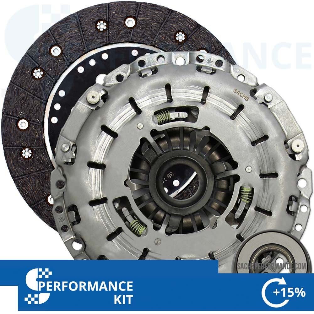

Sachs link clutch kit 3000951681 to the Leon CZEA -
6 speed manual. 230mm dia, Hub Profile 20,4x22,2-28N, Number of Teeth 28
Sachs have a performance range where they add -S to the part number.
Searching for 3000951681-S shows an performance version - they link to the Transporter!
Diameter [mm]: 230 - Number of Teeth: 28 - Hub Profile: 20,4x22,2-28N
Reinforced Clutch Kit, custom-modified.
Transmittable torque about 15% higher than the OE clutch kit.
Includes SACHS clutch cover, reinforced clutch disc with performance clutch friction material and SACHS release mechanism.
Manufacturer compare numbers
VW
03L 141 015 N
04E 141 015 K
03L 141 015 NX
02A 141 165 R
They don't mention the Leon with the -S version, but they do link the Transporter and the Leon with the standard part, and the the same VW OE numbers.
Luk are also linking the Leon CZEA and Transporter - which might help validate the link - or they have both copied incorrect data!

Thanks! this is perfect ill start on my second round of research hopefully this time round its much less epencive and actually fits this time

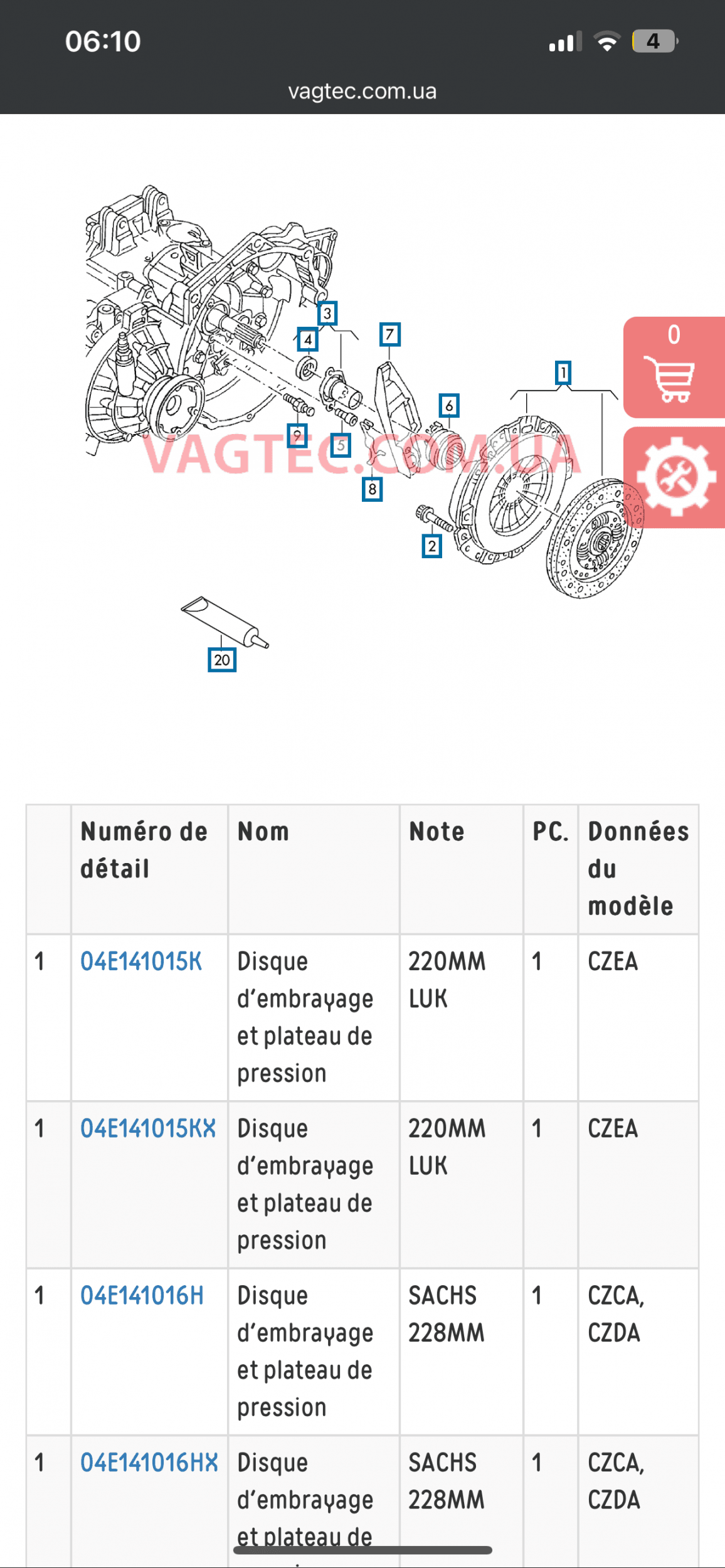

Bonjour je suis dans le meme cas seat leon 2018 czea 1.4 tsi 150
Je recherche un embrayage sachs mais je ne trouve pas la bonne références
Pouvez-vous m'aider ?

I wonder why the CZEA is 220mm and the CZDA is 228mm. The Sachs website lists 230mm. OEM is LUK, but the Sachs is better. The question is, which model exactly, along with the dual-mass flywheel?
