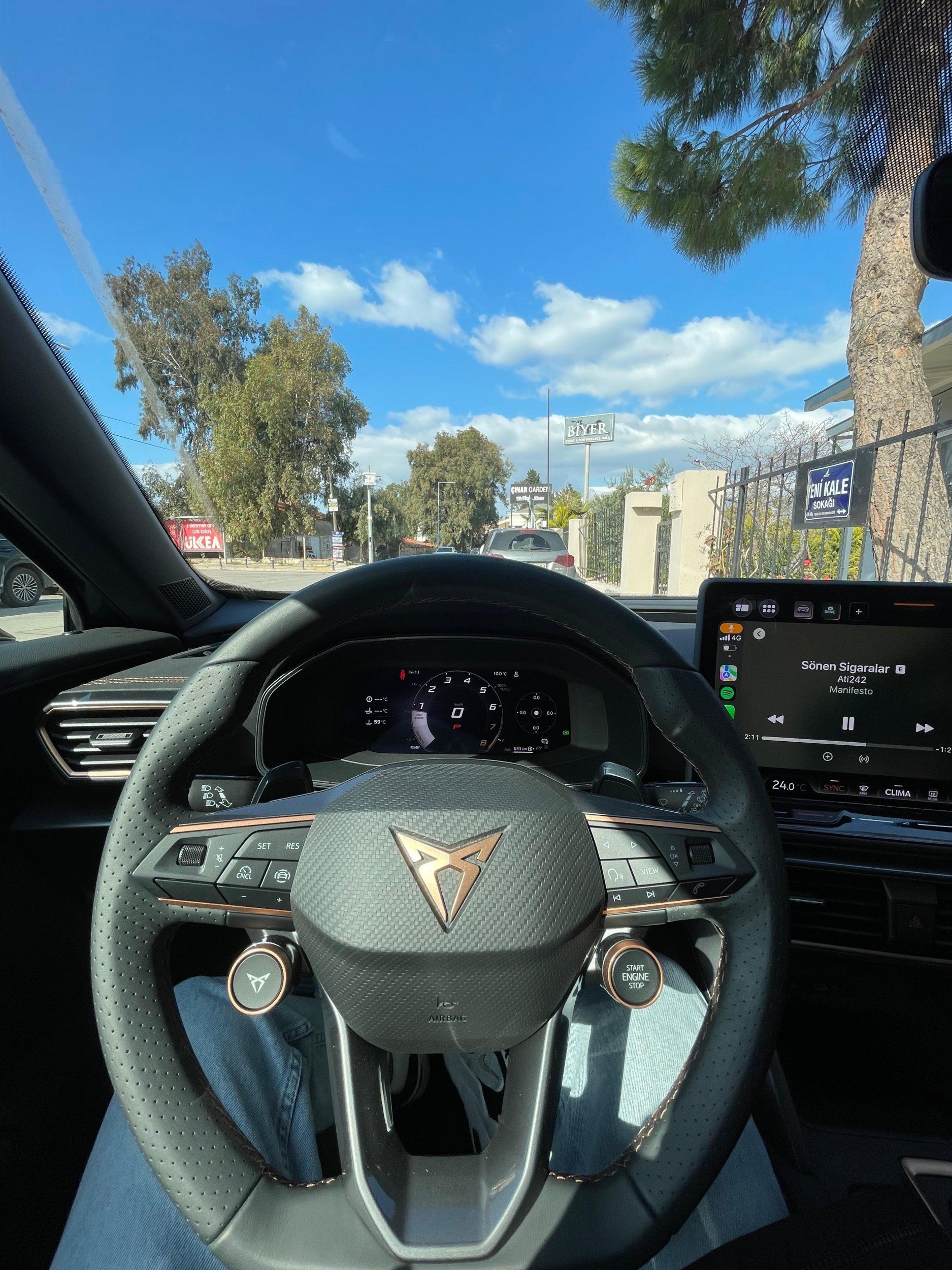

First of all hello.
I own a 2024 Cupra Formentor Standart, My vehicle currently has a Lane Assist and Front Assist systems.
I made an quick research about Side Assist and I learned that it works with Ambient Lighting.
For the ACC my car has the radar in the front but in the steering wheel ACC button is blank.
My car has the Lane Assist for the Travel Assist function.
Is it possible to activate all these functions just by codding them?

None of what you’ve just mentioned can be activated on your car with coding alone
Parts are required, and licenses for ACC are required
