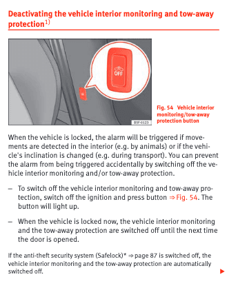

as @cairus said its possible to code this off but on some cars Seat provided a button to do this.
from my 2014 car manual
