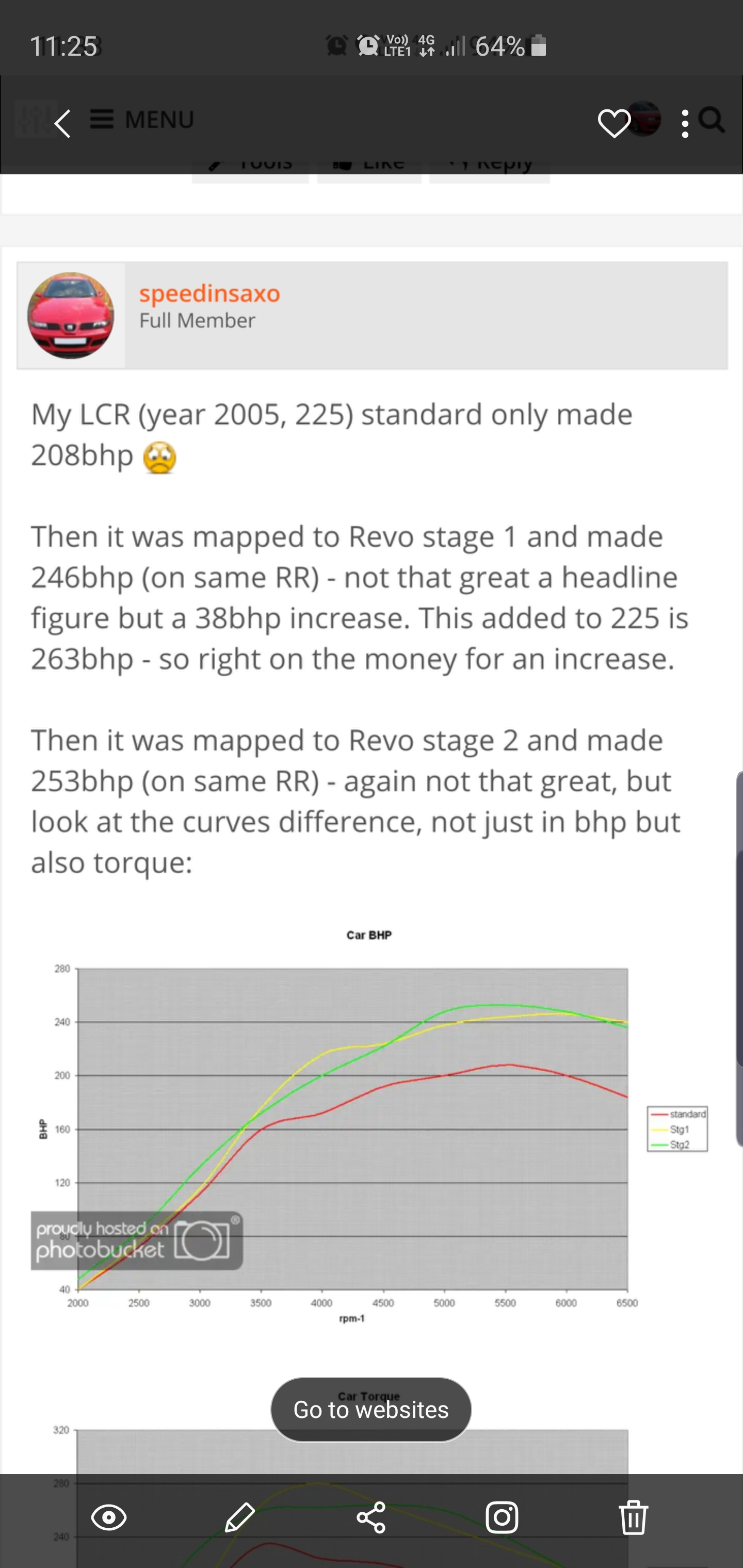

Im not sure who done the map , it used to be some ones on hear he said it made 264 on stage 1 then on a stage to it made 253 ?? I dont know what injectors its got ive just bought it

With those figures I’d check the turbo is original too?
Your way of calculating over 260 brake is bizarre.
You can’t jus add to 225 if the car makes 208. It’s 208.
Rr doesn’t have to be off.
I had similar when I mapped a refurbed turbo. Wouldn’t hold boost high up in the Rev range. so ended up with figures of 250 after mapping. Car was making 215 standard.
I can’t just add difference to 225 and say I got 260. That’s Silly.
Turned out to be a fake Chinese turbo sold as a recon original.
New turbo and bigger injectors and I’m up at 280+ and nr 300lbs.

Yeah, you're losing 13hp stock and 16hp at stage 1.
I'd give it a smoke test first of all and see if you have any leaks.

Thats not what ive worked out that was what the original own had put up on hear
Ahh
Ok. Sorry thought that was yours.
Makes no sense at all.
As said above. Few tests to do and go to a respected mapper.

Yeah i couldent get my head round how he ad worked that out ,yeah thats what ill do thanks for your advise
Rhyswh
Sep 14, 2018
36
I think what the original owner meant was his made 208 on the rollers and after a stage 1 made 246, so the difference is 38bhp. If you compare this to a stock CupraR of 225bhp with an increase of 38bhp you get 263bhp which is about right for a stage 1 cupraR........I believe the point being the stage 1 map was good and provided the extra power a stage 1 should, just that the car was already down on power. Don't think he claims the car was 263bhp at all just a comparison to confirm the stage 1 increase.
So your car has actually gone from 208bhp stock => 246bhp stage 1 => 253bhp stage 2..........considering you're not getting stage 1 power at stage 2 I would say something isn't right.
