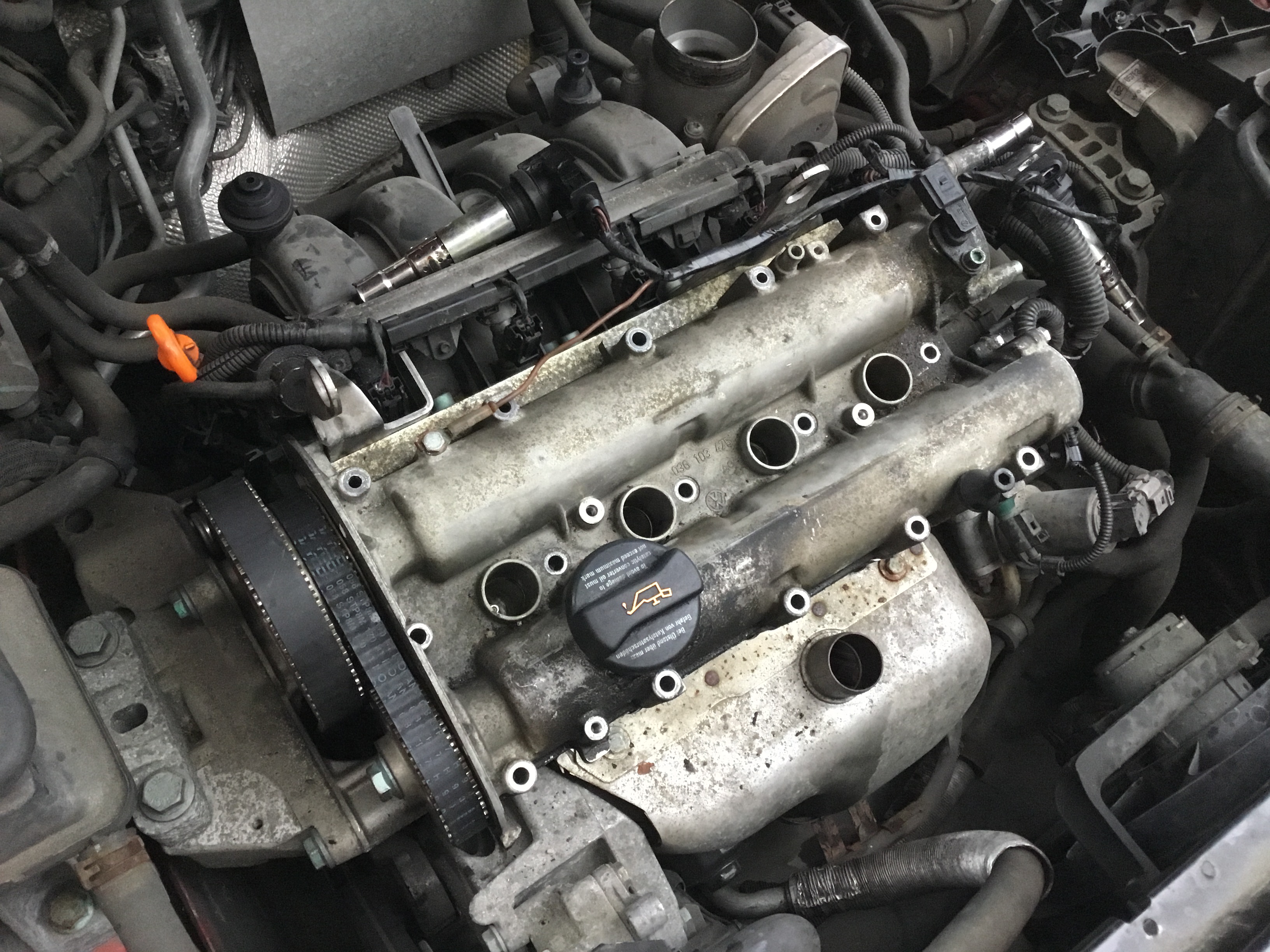

hi all,
Having problem trying to remove rocker cover. I have undone all bolts but it won’t budge near the side of the timing belt, when I wiggle it it looks like it’s connected to the belts.. anyone have ideas on this?
Thanks in advance
Rob

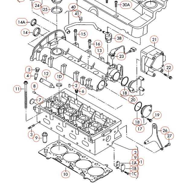

On the 1.4/1.6, from what I can see on OEMEPC.com it looks like the cams run directly in that top cover. Its not just a cam cover - it's the cam carrier.
Did you find that the "free end" of the cover has probably sprung up due to valve spring pressure?

Thanks for the replies, yes you were right it was a cam carrier! So I've put the cover back on.
The reason I was wanting to look into the valve cover was oil on the spark plugs, but after trying to remove the cam cover the engine is making a ticking/tapping noise I don't think its timing belt related as didn't move it around too much. Have I disturbed a cam or something?
I ran a engine cleaner through it, changed oil and oil filter and went for a little drive hoping it was debris or something in the up lifters but I still have the noise.
Any ideas on what I've done? :joystick: Any suggestions appreciated.
