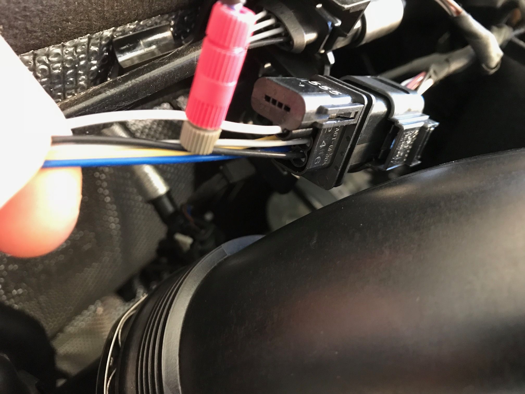

Which color wire would the o2 sensor be on the newer (2019) cupra? Theres no red wire. In place of it, theres a white wire. Would it be that one?
Yes it is the white wire as pictured here.

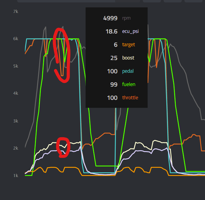

Tried MAP4 (I rarely do launches actually for launch control)
I understand it cuts off boost/throttle a bit from around 6k rpm? At least thats whats visible on logs & can be slightly felt while going full throttle (at every gear in high rpm, differs a bit from gear to gear).
MAP3 doesnt have this cut off and should be keeping higher boost also at higher rpm?
Default boost failsafe is 25. I see rarely it keeps hitting a bit over 25 (something like 25.4 on chart) & thus reducing throttle based on the limiter a tiny bit. Should I lift the limiter or keep it like this for now?
Contacted George yesterday, to see whats he reads out of the logs & if anything needs to be finetuned :)

We have 98 octane fuel here, so I guess ill try map3 three and see how its translating to logs.
In the log you can see on MAP4 the boost/throttle cutting at high rpm between gears.
Map 4 has a boost taper up top. It's for DSG7 cars, launch control will not be great with map 3. If you don't use LC you can use map 3 for a wee bit more power up top.
It is still a good idea to use auto shift boost redux to limit boost between shifts to save the clutch. A value of 60 or 70 is sound.
Great tip! Will check what the boost redux default value is.
I guess as the dsg soft is uncahnged, then its going to stay a bit slower (closer to original output) between changes anyway due to those circumstances stacking up.
