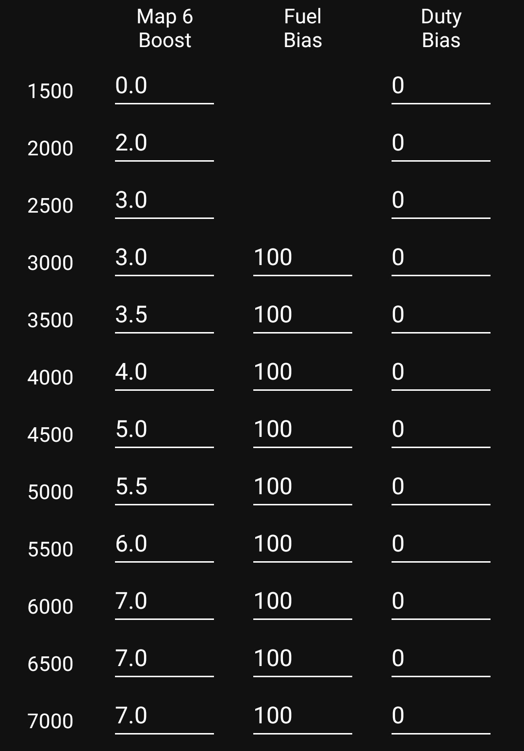

This is my Cupra 300 with JB4 + Stage 2 hardware(downpipe, exhaust, intercooler, air filter, modified intake, HPFP before I change turbo to bigger one)... Stock is realy not stock and is only JB4 turned off but still with Stage 2 hardware installed...
