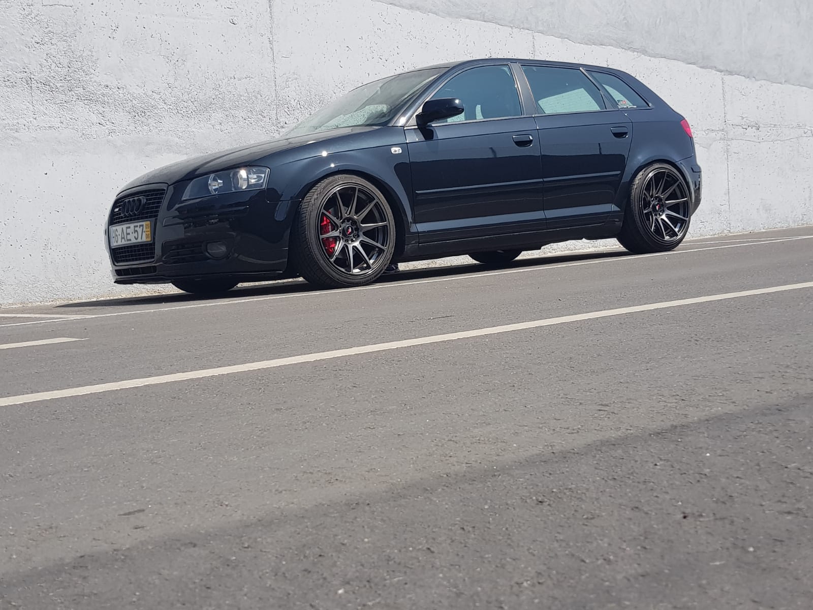

In attach I will send a photo of the wheels in a Audi A3, very simillar to Leon ( in my opinion
In this perspective, the wheels don't come off the chassie.. what to you think?

It looks as if narrow tyres have had to be fitted to the wheels on the Audi A3 in the picture to minimise the risk of rubbing. I personally don’t like the stretched look with tyres, and with stretched tyres, the tyre provides no protection to the edge of the wheel, so there’s a high risk of damage to the wheel if you park too close to pavements and high kerbs.
I’d say that on the A3 in the picture, even with stretched tyres it still looks as if there would be a risk of the tyres rubbing the bodywork, especially when cornering, if you’re driving on poor road surfaces and if you’re carrying 3 passengers (extra weight in the car, so it’ll ride lower). If you’re ever planning on lowering your car, then the risk of rubbing would increase.
I’d would still look for a set of wheels with a less aggressive offset. Just my opinion though, and maybe other forum members will have a differing point of view and add their comments to this discussion thread.
