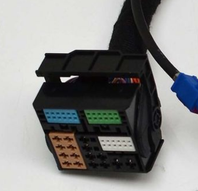

@ray have you actually fitted the reversing camera to the MIB unit yet, Reason I ask is the connections on the camera dont just plug into the mib.
No I haven’t, plan is to take the unit out of the glove compartment and see what plugs I would need to plug it in and go from there.
I bought it before realising I’d need to take off the rear bumper to fit.
Thanks for the answer. Taking the rear bumper off is easy, I did a how to here if that helps, The problem I have is I know there are some instructions on how to convert the yellow video feed on the camera (and the vast majority of them are like this) to fit into one of the square blocks that fit in the MIB1 Unit I have

Just to add in I did a quick review on here and found this thread that shows you how to do it .
With regards to the cable to plug into the MIB1 Unit I found this that seems to do what the above thread shows you need
