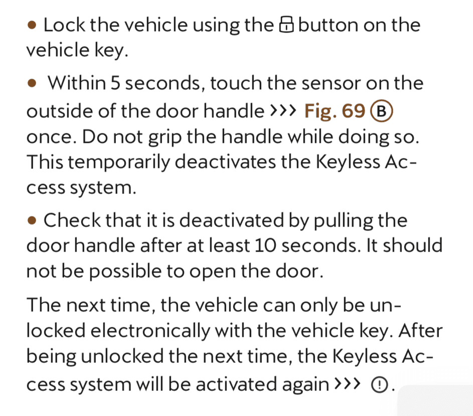

You can also turn off KESSY when you lock the car.
Yes, I always follow that process when locking my VW with keyless entry / keyless start. My car is too old to have the key fob with motion detection.
