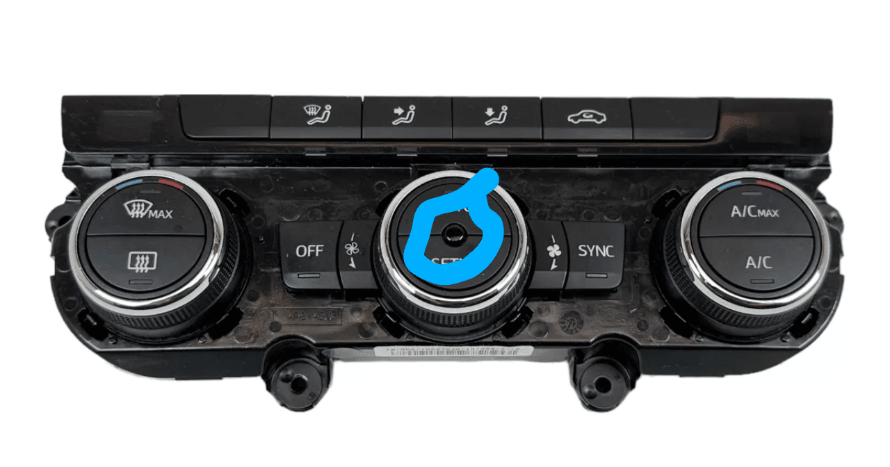

This is the Sensor
Reactions: Craig.

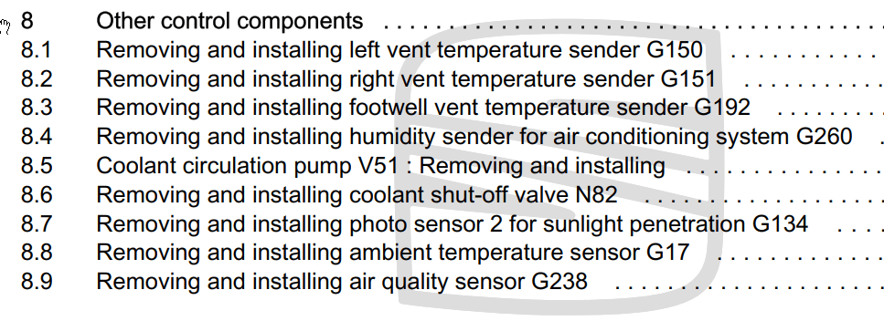

Thank you, the weird thing is, I thought there's a temp sensor on either side of the dash, just because it's dual climate, just wondering how does it see 26 on 1 side and 22 on other with 1 sensor being placed in the middle? Or it's more basic than that.
The service manual show sensors for left and right vents, footwell vents, etc. Doesn't mention anywhere that there's one in the middle of the control panel.....
Reactions: pesix

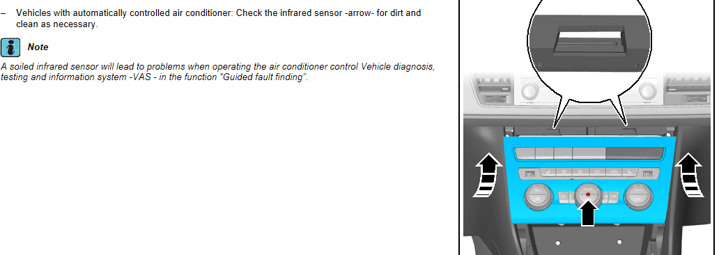

That is likely because it isn't a sensor that can be removed/installed, much like the photosensor in the instrument cluster that changes the dash illumination during daylight

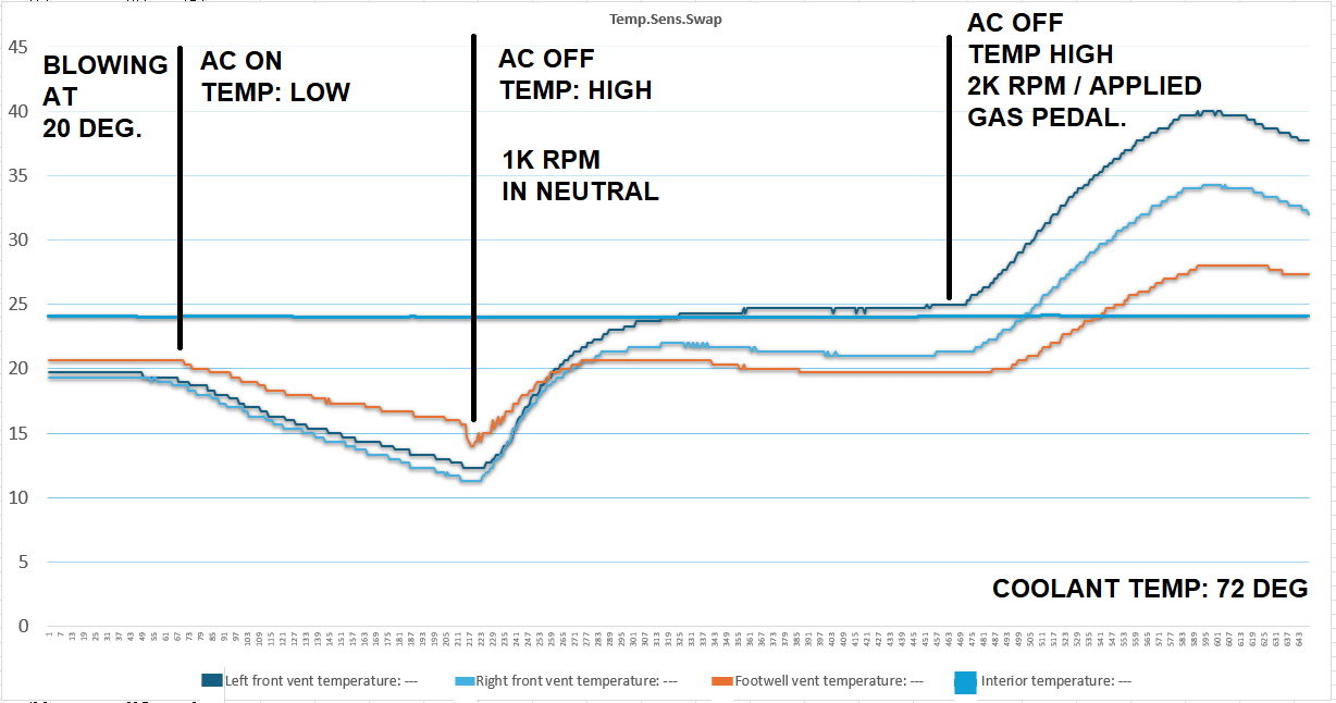

@ViperSlider @SteveGSXR600K1 Hi, got the tool to collect the data finally last night.
Graph shows ambient temperature initially, then switched on the AC with low temp followed by AC off and temp to the max.
Couple things I noticed right away:
1. Interior temperature was at 27 constant, didn't respond to any of these changes
- Had the windows open (+8 outside)
- I jumped out from the car in case the temperature sensor in the middle of the dash is picking up my temperature. Still sitting at it's 27 28 degrees.
2.Left front temperature does it's own thing and seems to be out of the range or calibration as it's almost always +5 degrees higher up.
-It did come down to similar numbers when AC was on and it triggered to pull the high 30's down to +19, they all were within 3-4 degrees as visible at data point 99.
3. Footwell temperature sensor has a different character to other 2 sensors.
All this was done with air blowing on footwell and face.
4. IR sensor in the middle of the AC unit didn't respond to being covered with plastic sheet, by hand to pick up any temperature change.
After this test, it still had the same characteristics of cutting off after reaching each incremental step up.
No fault codes present.
Any suggestions? Tempted to find the location for each of these temp. sensors and swap them around to see if the issue is now switched to the other side. And if AC unit reading is a separate issue? Thank you.

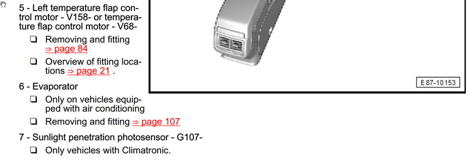

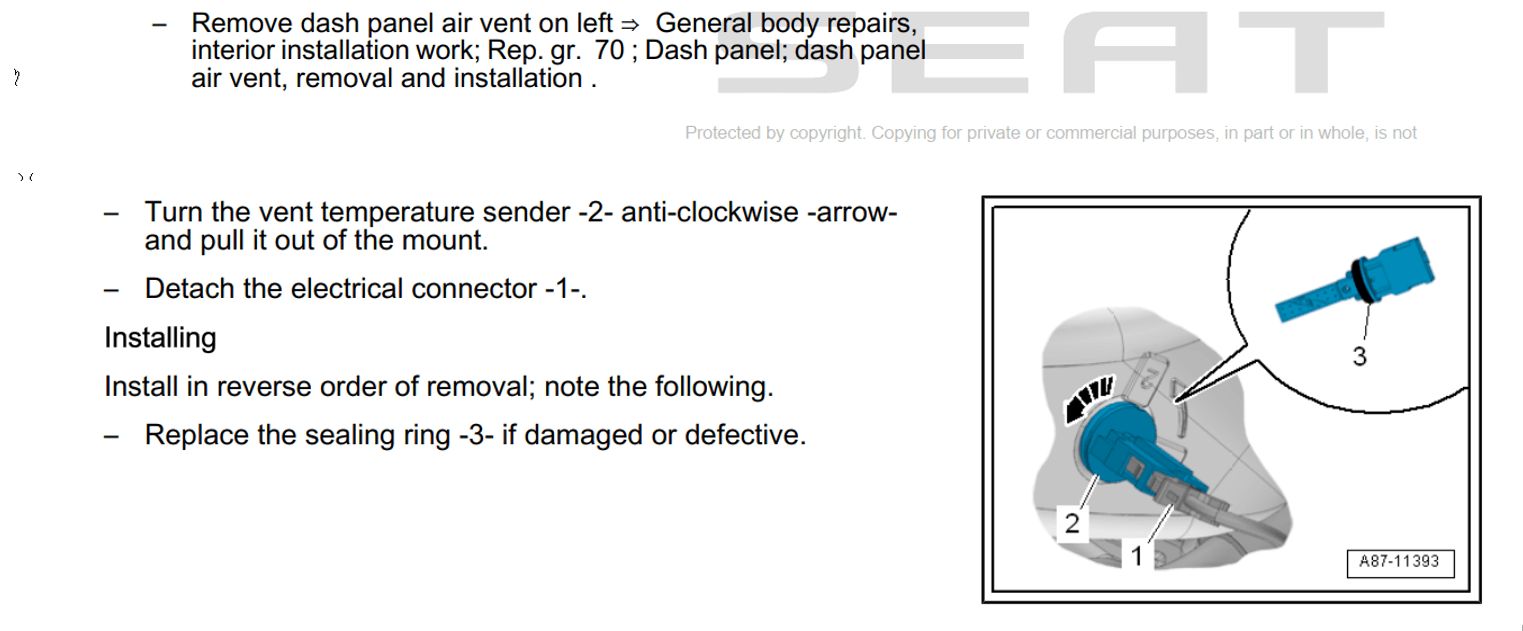

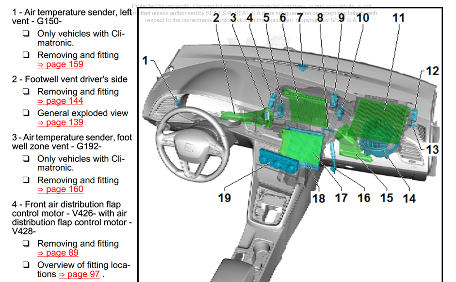

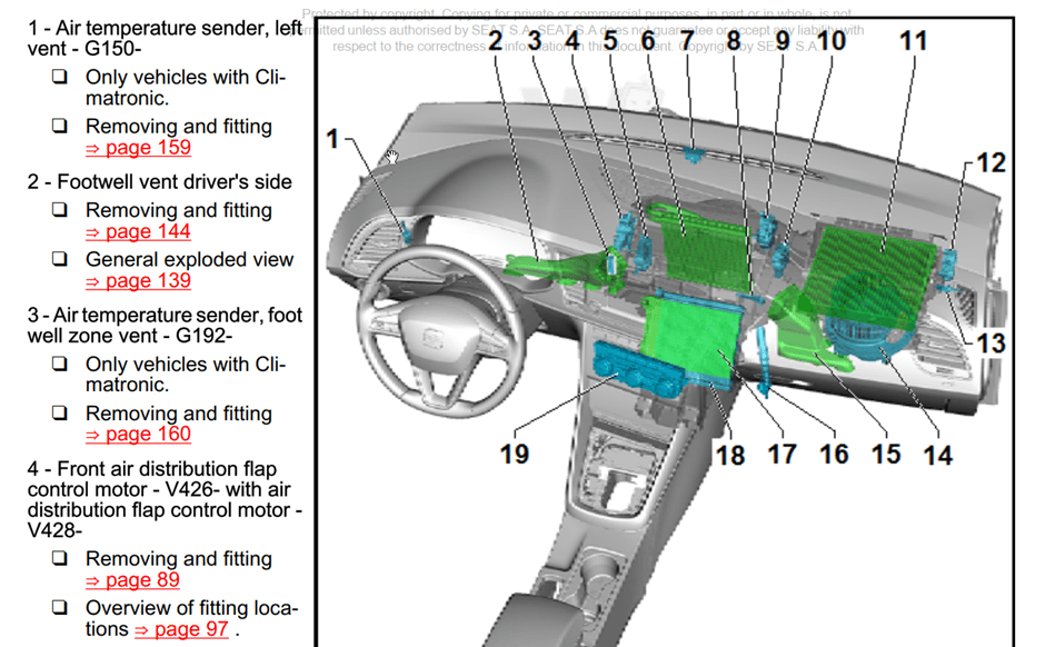

Seems like you're getting somewhere! Here's a diagram showing all the sensor locations:
Reactions: pesix
@SteveGSXR600K1 Thank you for the chart. Here's the latest:
1. Decided to swap the left and right vent temperature sensors around.
2. Both visually in their accurate positions
3. Swapped them around, assembled the parts back together
4. Did a scan via OBD11 - 1 Fault:
B108715 - Left vent temperature sensor Open circuit/short circuit to B+
Intermittent
Cleared the code, climate control in action for couple of minutes, scanned again - no Faults.
5. Live data recorded, same as last time:
- Interior temperature sensor must be connected to Spanish weather via WiFI? Reading HIGH while it's +10 outside / windows / doors open.
- Left hand side temperature sensor still tends to read +5 +6 degrees higher?
Coolant was coming up to 72 degrees, when applied the revs - a considerate amount of heat started to come in.
At this point I've ruled out the fact that swapping the LEFT/RIGHT sensors doesn't transfer the issue to one or another side. Or is there a reason to think it's not the case?
All of them tend to respond to the change in temperature.
Is the problem the A/C unit itself?
Re. the increased revs - should I be looking elsewhere for the problem? @ViperSlider / @SteveGSXR600K1
It's not loosing coolant or anything like that.
Thank you!

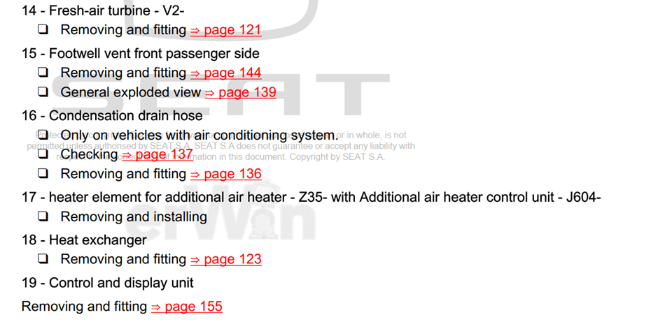

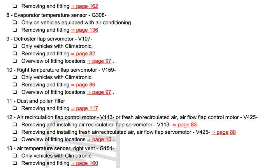

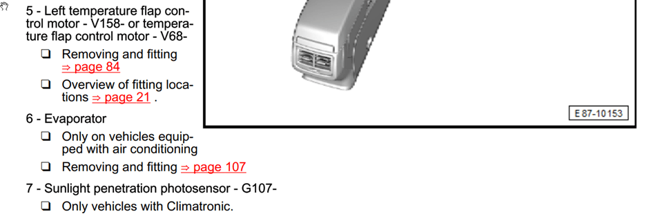

Where did you get the manual from? I'd really like to see how the 2 vent sensors and the footwell sensor join up to the main unit. I'm thinking of fitting the auto climate control unit.
There ya go lad
Reactions: kazzz25
There ya go lad
