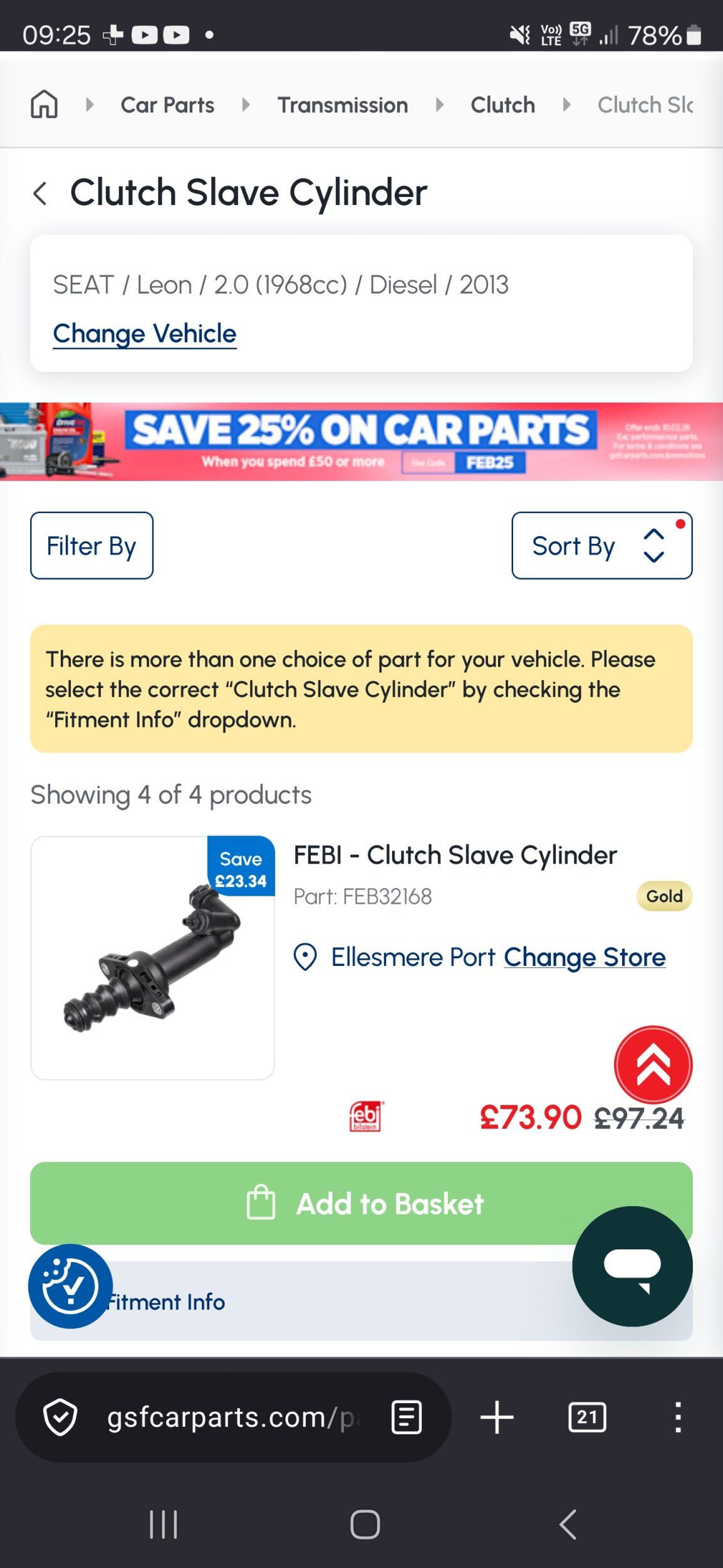

3. Clutch release is slow to return and doesn't follow my foot. It hasn't since I owned the car (about 2.5years) I had a new sachs clutch kit & flywheel done tail end of last year and I have since upgraded the clutch line to a steel hose from Darkside Developments that removed the little restrictor valve thinking that would solve the issue but it hasn't. My car has a CSC in bellhousing (correct me if im wrong) which was done with the clutch so it can't be that and also the issue was apparent beforehand. However GSF / ECP show a slave cylinder for my car which is the externally attached one as pictured

3. No, you have a stupid clutch centre release bearing. Think I would change your clutch master cylinder.
