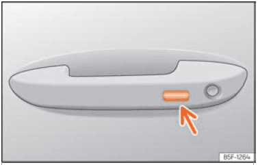

Took delivery of my new 1.5 FR today, I was expecting keyless entry as well as keyless start. There’s no dimple on the door handle and whatever I do I can’t make it lock / unlock. Does this model not have it?

I think you’re wrong there. There’s only 2 types of keyless, one with only start stop and the other with entry too. To lock on the latter you press/touch the dimple on the door handleThe keyless system is very badly explained by Seat. In Ireland its an optional extra and included on XC and FR+ but on my FR+ it is only keyless entry/start not keyless locking, so you still have to pull the key out to lock. there is KESSY with SAFE option which seems to be the one with keyless locking, but the specs document really doesnt explain it well at all!
Hmmm ok. The keyless entry has worked every time for me, no issues. I did try to lock it by pressing the dimple on the door handle but that did nothing.I think you’re wrong there. There’s only 2 types of keyless, one with only start stop and the other with entry too. To lock on the latter you press/touch the dimple on the door handle
Edit: SAFE when it comes to KESSY is deadlocks. If you're inside when locked with SAFE you won't get out.
Kessy: You cover the dimple with the back of your hand or front thumb if you dont fancy back of the hand. Easier back of the fingers to lock (back of the hand), grab handle to open. No pressing, proximity sensor.Hmmm ok. The keyless entry has worked every time for me, no issues. I did try to lock it by pressing the dimple on the door handle but that did nothing.

WOW! it works! it would be nice to see that in the manual! maybe it was and i didnt see it, but THANK YOU for the info! I know will not be forgetting to lock the car or pulling the key out!Kessy: You cover the dimple with the back of your hand or front thumb if you dont fancy back of the hand. Easier back of the fingers to lock (back of the hand), grab handle to open. No pressing, proximity sensor.
