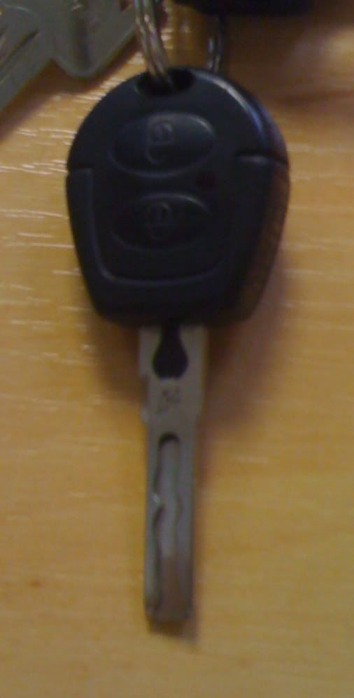

Here's the deal. I have this key
and the unlock button is very intermittent sometimes it works, sometimes I have to push about 50 times to get it to work etc etc, so I want to change it for a new key.

So is that the small PCB next to the battery?
What about the small tube piece, technical I know :), by the blade end of the key?
The tube is a transponder cased in glass lol.
I'm just wondering if the PCB in you're current key will fit a new flip key case... hmmm. Maybe someone can confirm this. I have only done the swap from flip key to flip key.
be very very careful with the transponder!
i was swaping from flip key to flip key last week and broke the transponder tube :( now the key is totally useless as this controls the immobiliser
seat dealer wants £123 all in to sort it!!!!! :censored:
they can't just replace the transponder tube, they replace the full top of the key, including a new blade getting cut which was £75 then £40+VAT for programming!
if i'd have know that i would've just got a full new flip key at the cost of £160 and kept the tatty looking one for a spare :(
with regards to the above question. don't see how it wouldn't work tbh but don't take that as gospel lol
the guy in the seat dealer asked where i bought my key from as i got mine off ebay (2 button one) and said that its designed so you can't just swap bits over, well on the bladed part anyway. i'd be very very wary trying to remove the transponder
Careful yes but they're not that difficult. I scratched mine out with a pin. New transponders are only about £7 but will need to be coded. Some have heated up the plastic with a lighter/thinners but I scratched the glue away.
All in all less than £50 total for new fob, blade, cutting and self programming of CL, transponder swap.
PS I doubt your PCB will fit from that two button to a 3 button case. However I'm not sure if you buy a full complete fob if it'll still be programmed to your car.
