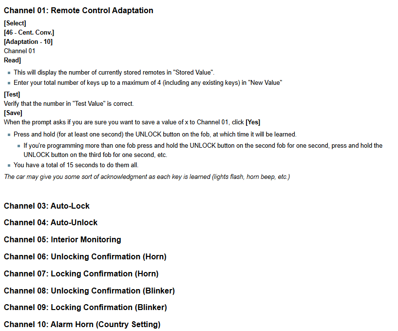

Ok well ur half way to having it working properly, ive had my 3 button fob working for around 8 yrs now, the boot unlocks at touch of button without unlocking the car, when u close boot it re arms that part of the system but you need it coding in through vcds. I can't help you there but mine was coded in through vcds and its never been a issue works 1st time every time.
Reactions: mty12345
Who coded it for you?

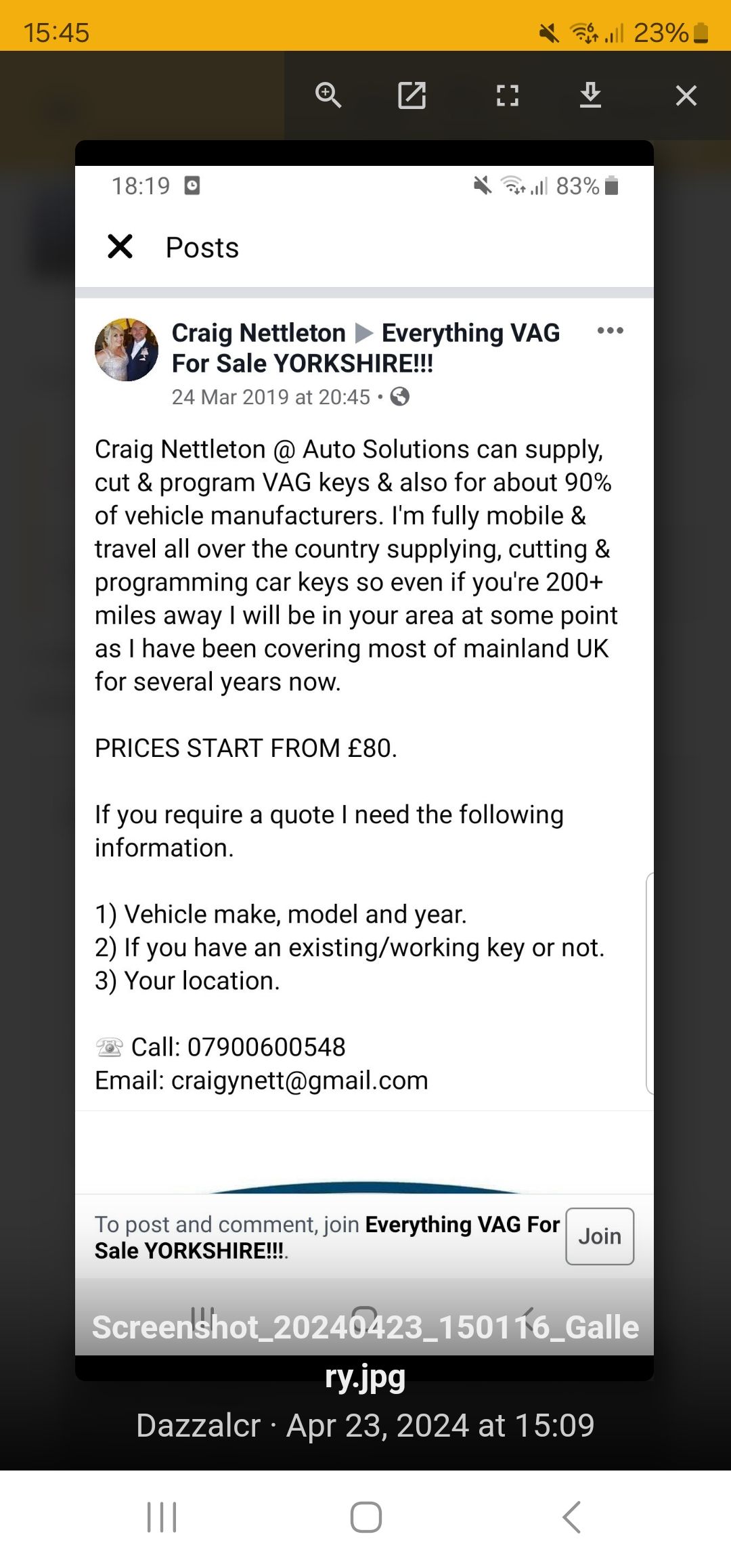

Thought it was you, I shared this info last time you asked so you decided to cheap out and take it to general locksmith, here is the info again but he may have retired by now, you need someone who knows their stuff on vcds not a general shop. Don't know what it cost that was when I had it done ages ago

That guy who did mine was ace and well know for knowing what he does, you do need a key with a certain transponder frequency chip, and then he spent a good 20 mins on vcds doing his magic, he said if you don't know what ur doing on vcds you can **** things up. Last time I looked about a yr back people where charging around 250 for a key and chip and cutting but you needed someone with vcds again, it seems expensive now, I paid 120 I think.
