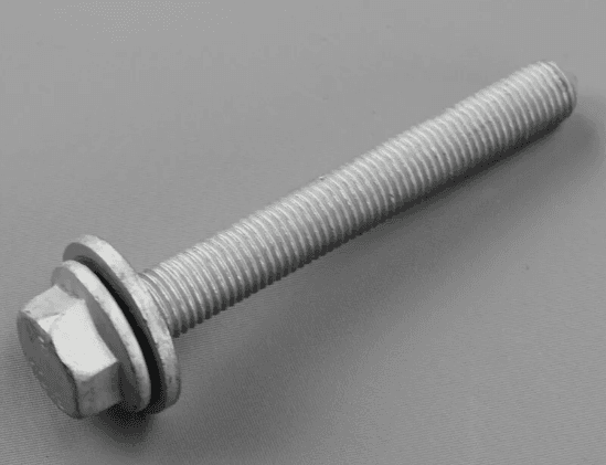

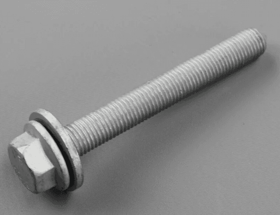

The 4x large subframe bolts are :
N10785401 Hexagon flange screw M12X1,5X95
The genuine bolts don't contain any thread lock.

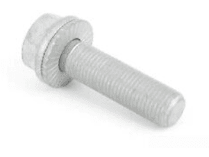

The bolt for the Dogbone mount is
N91201001 hexagon head bolt M14X1,5X50
Again - no thread lock. It has a serrated washer - to act as a locking mechanism.
