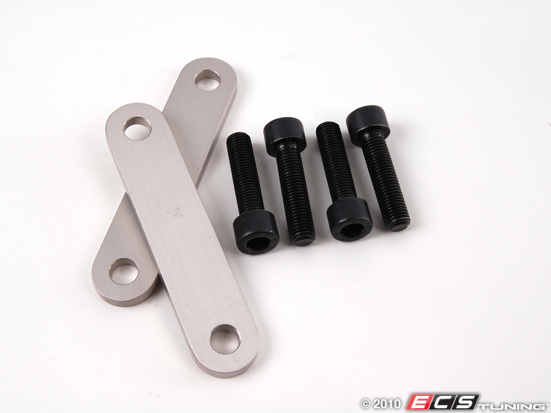

To fit 256mm rear brakes from a 4WD to a FWD Leon, a spacer is needed to push the caliper carrier 6mm outwards:
There are many producers, some do it in aluminium, others in steel. Steel is better, it won't corrode as aluminium mounted on steel does in salty environments. N & M Performance Parts (eBay: nandmperformanceparts ) is based in the UK and provides rather cheaply a spacer made from cadmium-plated steel.

Fits on the same caliper, needs the 6mm spacer to move the caliper outwards.

Asked for a set of 239mm discs. Already had a steel 6mm spacer kit for an older project. All other original parts fit by design.
When fitted, the dust shield has to be bent back with pliers.
