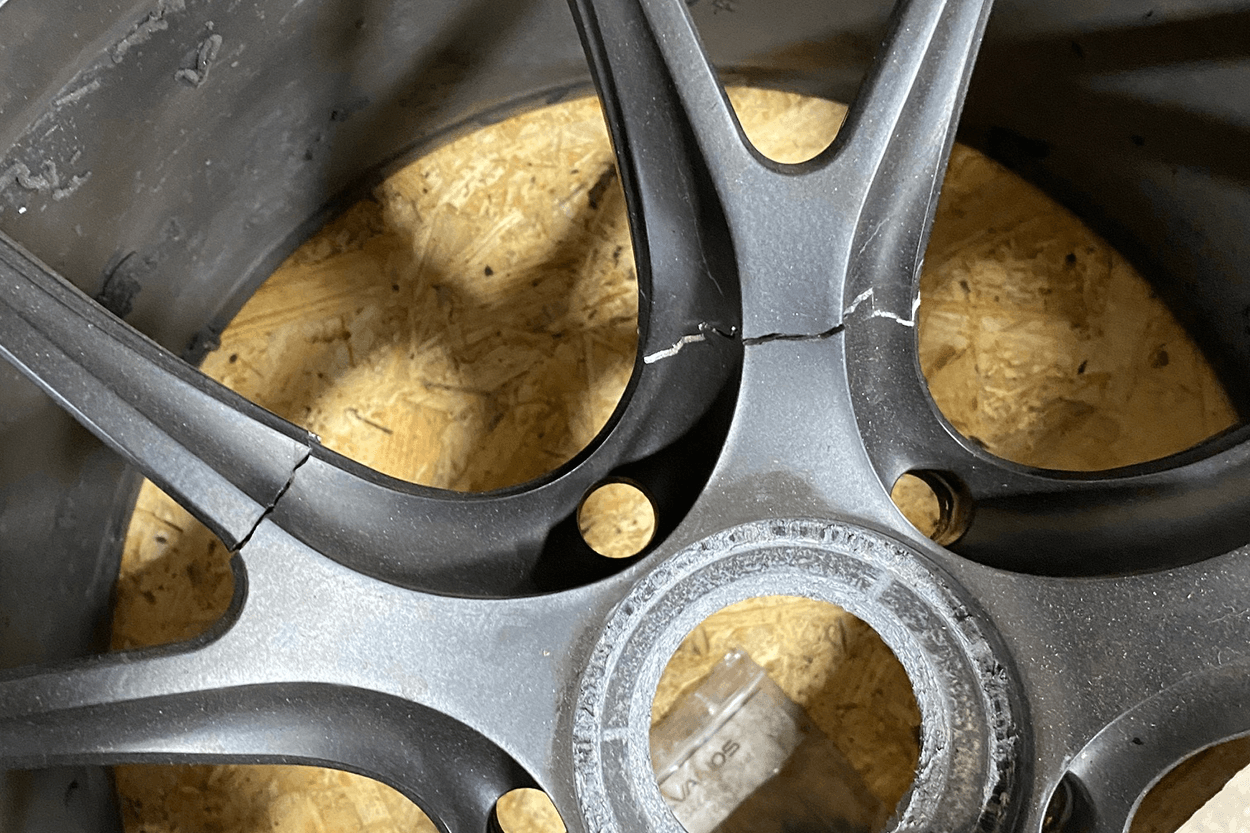

I was forced into a pothole last week - buckled my front wheel, cracked the rear, slashed the front tyre and damaged the rear too. A real shame as I quite liked the 18s I have (the nice, sweeping 'performance' ones - probably the same as you), and SEAT Direct Parts want £600 per wheel after postage... Thinking about some REVO RFO18s, but want silver, so if they can't find me a set then it'll have to be Bola or (wallet wince) OZ.
I think the suspension and everything is okay (car goes in a straight line and nothing has fallen off yet), but we'll have to see once it's lifted and everything is off - I've bent a track rod doing much less. Just waiting to be told where to go by the council after they read my claim...

Check out Facebook Marketplace and Gumtree, quite often you'll find people selling *some* but not a full set of wheels for a good price. People that have buckled one wheel, realised a single replacement was too expensive, so just bought a whole new set and are now selling three wheels for like 100 quid. I've done this a fair few times and picked up absolute bargains because of it.

Personally, I'm just not keen on eBay wheels or anything... having been a passenger in a car during a blowout as a result of a cracked rim when I was younger (hello barrier, fancy seeing you cave my door in), I'd rather just get a new set of wheels - especially as I can get them for a lower price than retail...

Think you'll be fine. I've done it COUNTLESS times and only ever been stung once. (Bought a set of BMW E46 wheels which had a very subtle dent in one of them that I didn't notice until I brought them home)
Just make sure you give them a good look over, look for cracks, dents, buckles, welds, curious locations/quantities of wheel weights, that sort of thing. Bring a torch and a cloth to clean up the inside since they are usually super dirty and hide damage.
I wish I still had the photo, but some years ago I bought a Subaru Outback, 2008, loved it dearly and after a few weeks driving I noticed a very weird shudder at certain speeds. Assumed wheels were out of balance or a tyre was going bad, but ignored it for a bit, kept driving. Then one day after a good 75mph motorway run, i came home and went right, let's check this properly, and to my horror, four of the five spokes holding one of the wheels together, looked like this: (not my photo)
