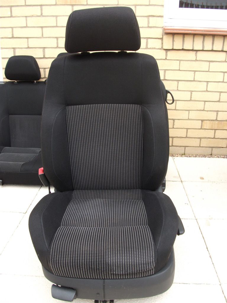

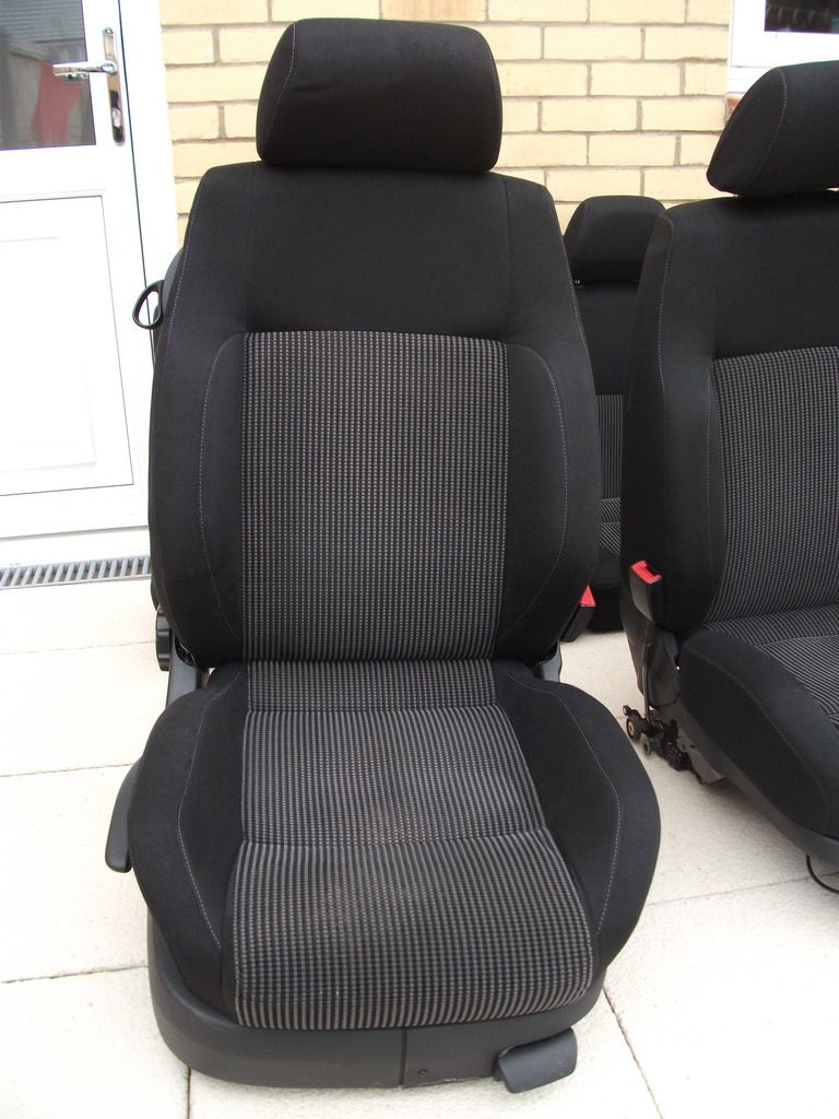

After getting my funds back on track I went looking for some heated seats. I still hadn’t found mk4 Golf heated recaro’s so decided to source some standard heated seats from the golf. Sets came up and good money was asked for them, a couple of months went by when I found a set of 3dr heated seats on the bay going for not a lot. Well I won them and picked them up 2 days later and got them back home.

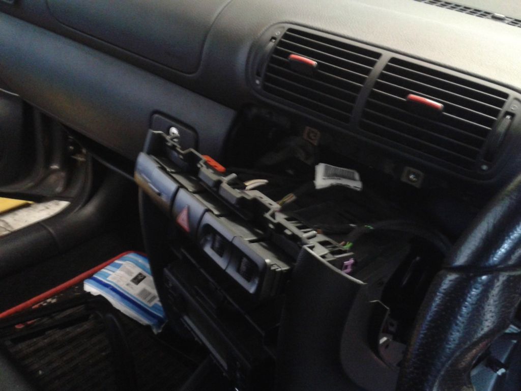

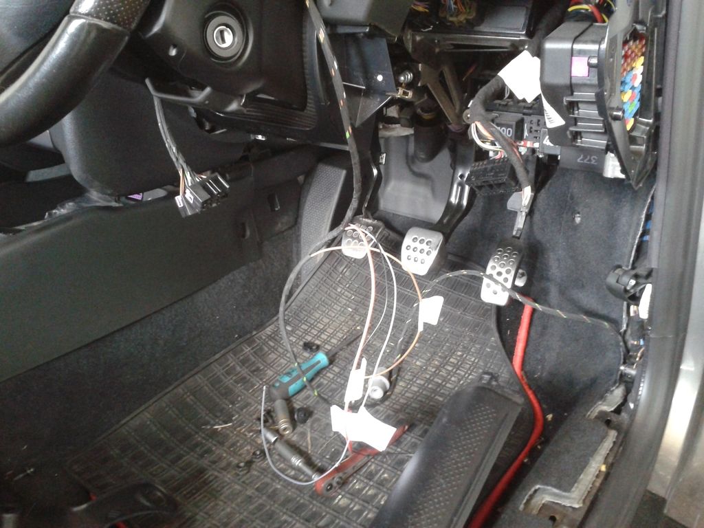

I labelled the loom up prior so I knew where the pins would locate. There are several guides on ukmkiv and vwvortex sites so they gave me a better idea of what I was doing. I took my time pulled the dash apart and side panels.
Once the loom was roughly in place I disconnected the battery and started placing the wiring loom into place then plugged it up to the fuse box and put the switches in.
I tested the seats I had bought and hey presto they worked! I was in business, so my worry that I had bought duffer cheap seats went away.
