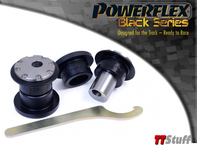

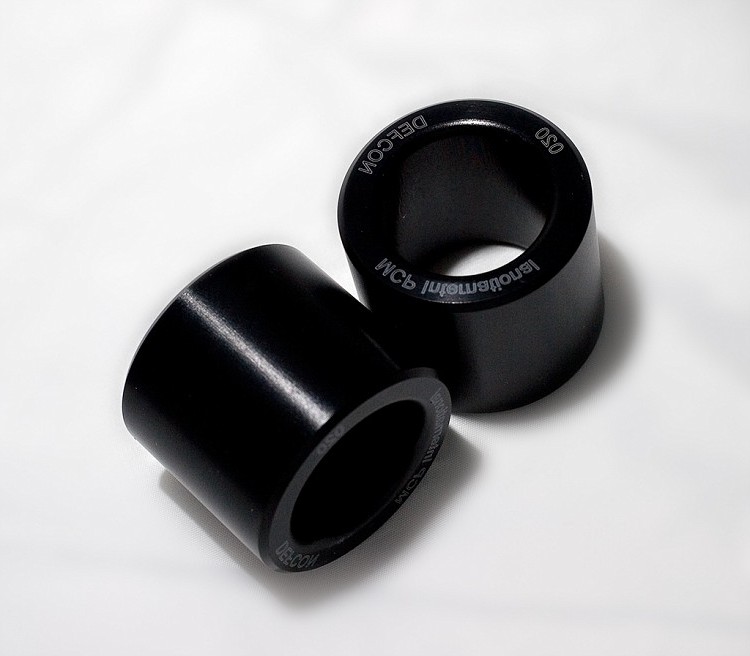

If you can I would do the whole lot. As for one that you would feel i would go for the front and rear of the lower arms. Again it depends what you use your car for. You can use either the better than standard purple and yellow stuff. Or the even stiffer black stuff. There is an option for the rear of the lower arms to use a spherical bearing set up that will reduce movement. And then on the front of the arms you have either 45mm or 30mm bushes. I think all leons are 45mm. A company called cookbot make an insert sleaves so you push that in to your lower arm then then use the 30mm bush this refuses movement and I creases stiffness and handleing. They also make camber adjustable bushes too.
