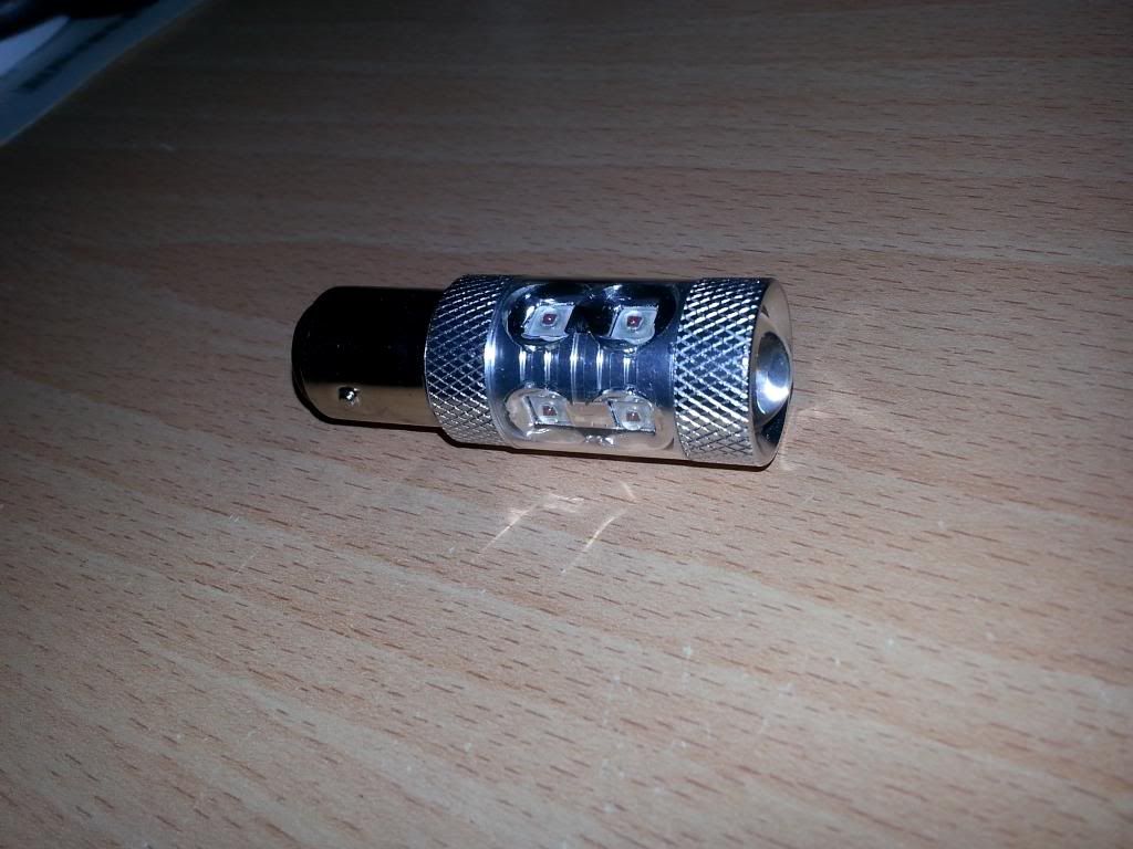

So I bought some nice bright 50w cree bulbs, but like the previous ones, they came on by themselves when I started the engine and they got very bright when I actually turned on the headlights.
This is what they look like:
So I think I need resistors, but because there are 2 wires plus earth, will I need 2 resistors each side?
