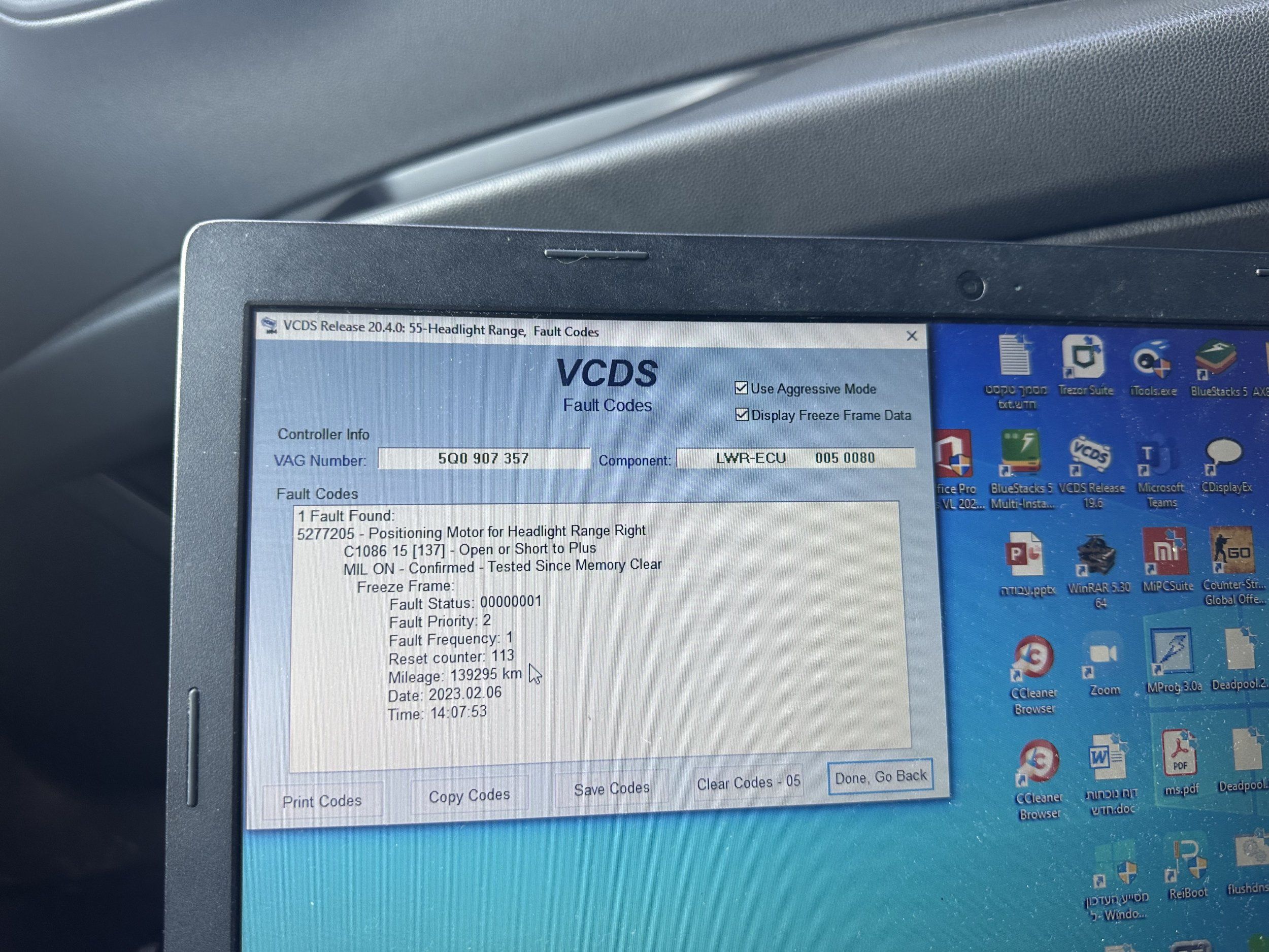

I did it as you can see in the pic..

Well, as the positioning motor has a fault as well as the various lamps in the light unit, it could be corroded connections in the light unit or going to it. Also could be the 'control unit' for that lamp.

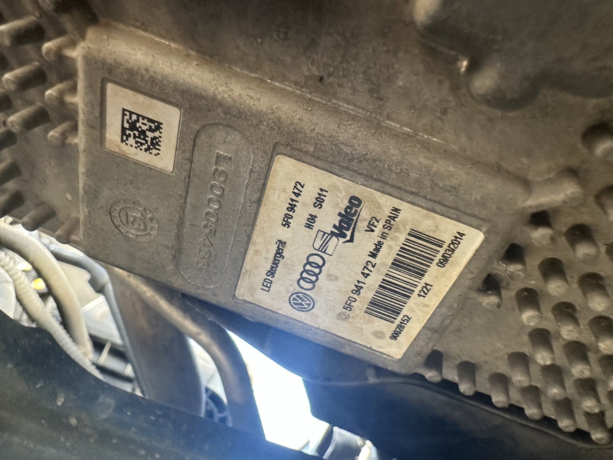

Well I tried the connector seems fine tested for + looks ok probably the control unit?
This one?
Reactions: Haych
Not sure how easy it is to remove the headlights, but might be worth seeing if you could swap them over to test if the issue follows the leadlight or stays on the right side, which would indicated a wiring issue. There is a control unit on the headlights, could try swapping them over first.
Range control errors can be created by broken levelling sensors.
I am unsure where they would be on your mk3 but on the mk2 they are attached front and rear to the suspension arms
