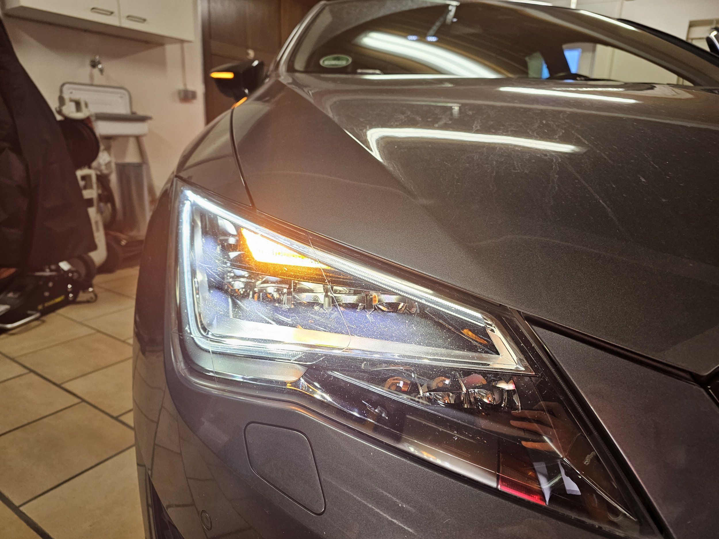

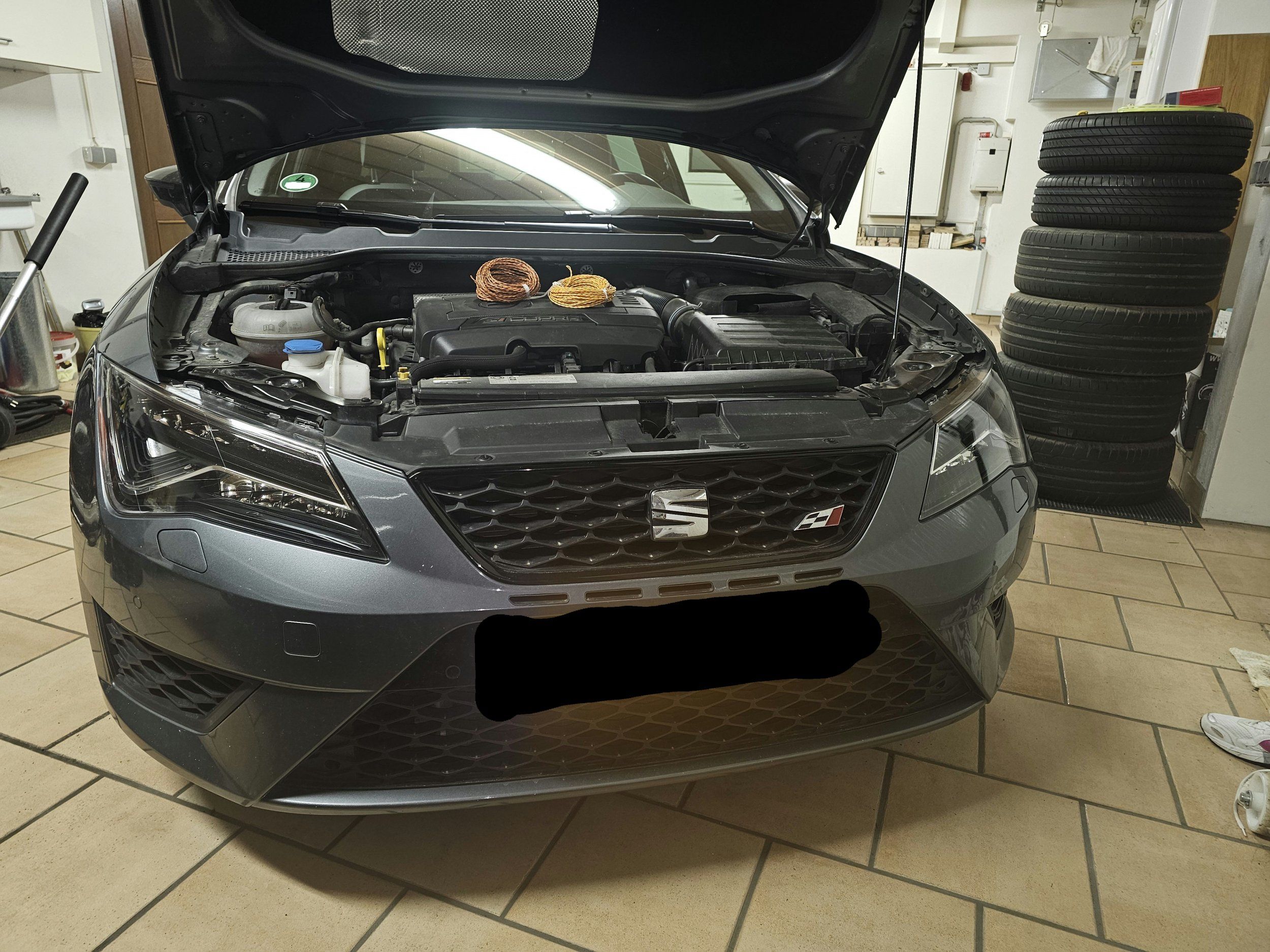

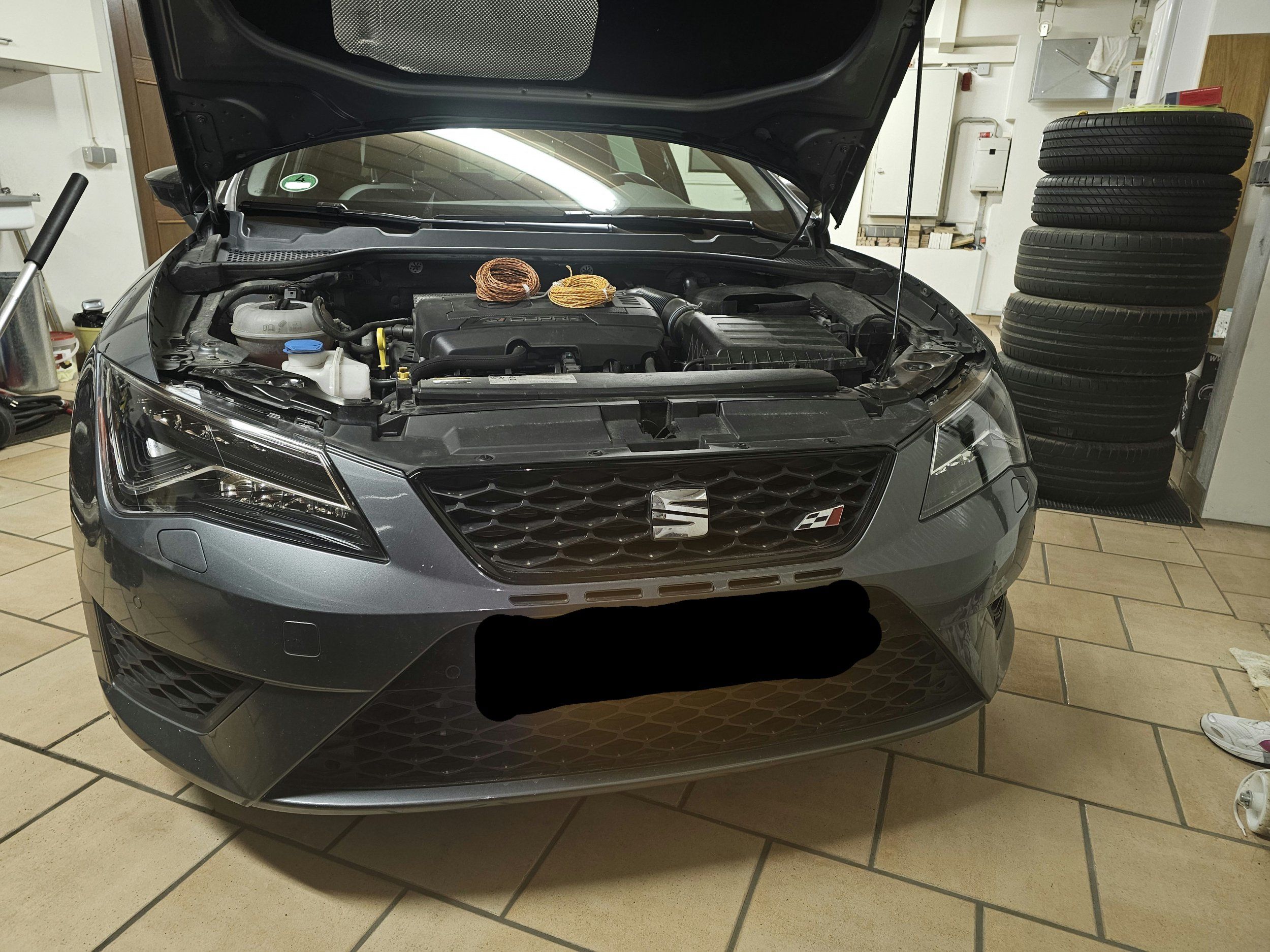

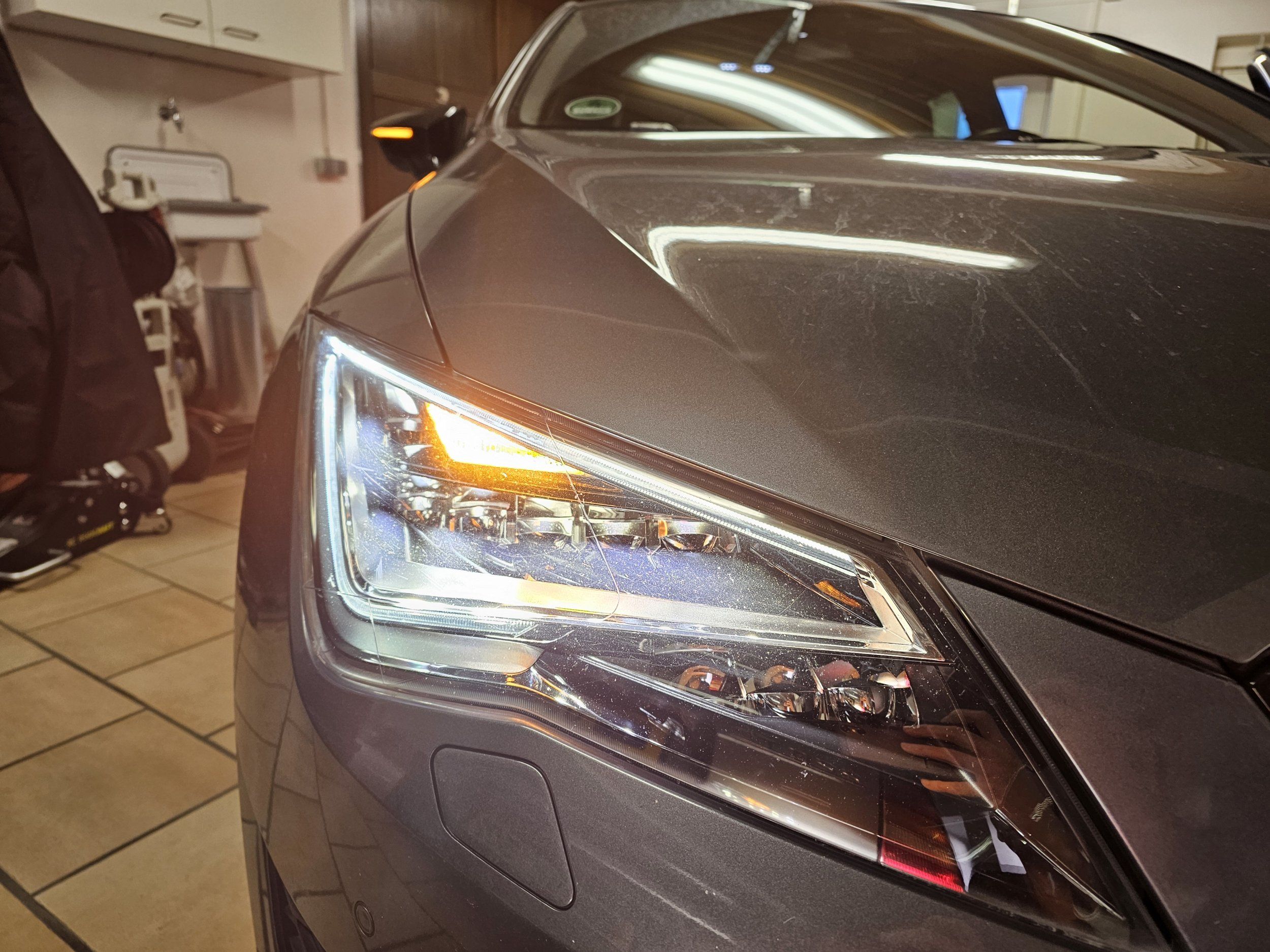

Facelift LEDs are much better, especially in terms of optics. I switched from pre-facelift LEDs three months ago. It wasn’t easy, but now that the work is done, I can say it wasn’t particularly difficult either.
Everything was done by me, except for the CP removal, which I had help with (no odis online account). Contrary to what was said here, it is doable on your own. I don't have any special skills when it comes to working on cars. After doing the backlight retrofit and upgrading the radio from 5.8" to 8", this was only the third retrofit I've ever done.
(The total cost of the headlight retrofit was under €1,300 — not including the cost of the ODIS China clone and VCP)

View attachment 48774 View attachment 48775
Did you have to change the bonnet and bumper to fit the facelift lights? Seen a few posts that say they need to be changed.
Dec 10, 2024
That is not true. As you can see in my pictures, it’s the stock pre-facelift (Cupra) bumper and bonnet. The headlights are exactly the same size and shape, so no modifications are needed. Of course we are speaking from Leon3 pFL to facelift and not to Leon4.
