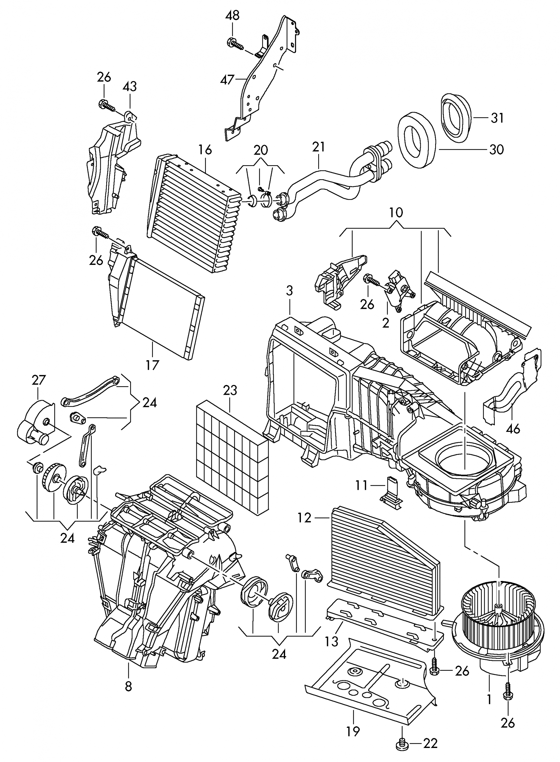

I've attached an image from SEAT Etka that shows all items within the heater fan system under dashboard, from an Altea, look at item's (1) = fan motor, and item (11) = fan resistor.
(1) Fan motor
Part number 1K1 819 015
(11) Fan resistor
Part number 1K0 959 263A
You've mentioned you can hear a squeaky noise when the fan motor is switched on, i.e spinning.
This could well be the fan motor bearings are wearing out.
Regarding the fan resistor it should be located close to where the fan motor is, as it needs good air flow to keep it cool otherwise the resistor will get far too hot and burn out prematurely.
The fan resistor will either be located at the bottom of the fan housing, or might be located slightly higher up behind glovebox like on my Ibiza, in which case it'll need to be removed i.e glovebox.
LHD Altea will have the fan motor on the right side = passenger side. The fan resistor I think will be lower down, or if slightly higher will be above fan motor in the fan housing shroud.
On a RHD Altea the interior fan motor system will be the mirror image to LHD and vise versa.
